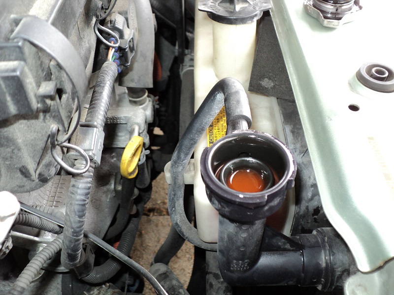

    You need to check the coolant level at the radiator itself! Ignore the bottle. Once it is dry, you have to refill the entire system (radiator, bottle AND bleed the air out). Just putting the SLLC in the bottle is NOT sufficient.
    Lots of info here on Prius Chat about how to bleed the system. Remember the radiator is divided into two sections. One part is for the ICE. The other part is for the inverter.
    Here is a pic of what the radiator should look like when it is full. If yours doesn't look like the picture below, then you need to fill er up and bleed the system. Only then will you overheating go away. Also do as pointed out above. Look for weeping at the water pump. A tell tale sign is a strip on the underside of the hood. The strip will run from the front of the hood towards the windshield. Might be a little pink also, but definitely a color change. If you see that, your water pump is leaking and needs to be replaced. It is a common item on the Gen II. I had to replace ours before I traded it in, many other's have had the same problem. Don't let the ICE overheat. If it ever does, the heads and stuff will never be the same.
    Hint: In order to access the radiator cap, you have to remove the splash guard over the radiator. Real easy to do, use a Phillips head screw driver, while turning the little plastic looking screws on the splash guard counter clock wise, apply slight pressure underneath the guard. The little clip will come up and you can remove it. Remove all the clips, I think there is 8 of them. Save the clips and reuse them. Once you get the guard off, loosen the cap and remove it. Check the fluid level in the radiator itself, NOT the bottle. If it does not look exactly like what you see here, you are definitely low on coolant. Remember, fill both the bottle and the radiator and then bleed all the air out of the system. Don't forget to check the water pump for leaks.
    Make certain the ICE is cold BEFORE you remove the cap on the radiator.
    Ron (dorunron)
