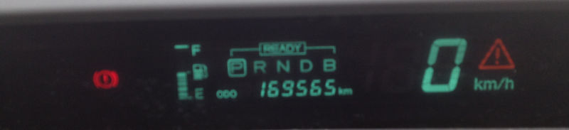

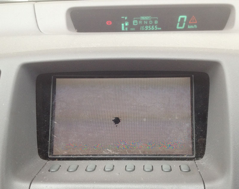

    Main Problem: At times when the turtle sign comes, the engines makes a lot of noise. It feels like the engine is overworking. I also hear some air suction kind of sound from the back of the car (I believe it is to do with the main battery). The car will not accelerate. I need to go to the road side and then turn off the car. Wait for a little while (may be 5 minutes). Turn the engine on and then drive again.
    Other problem:
    1. Red Triangle is always on (see the pic)
    2. Dash Board screen is always and now completely white so I cannot see any error message (see the pic)

    BTW: The first thing I suppose I need to do is to fix that dashboard monitor (it obviously works). Any suggestions, how this can be achieved, please?

    well, it almost looks like your screen is broken. ok, here is what you should do. disconnect your negative terminal on your prius 12 volt battery in the trunk and then hold push the brake pedal for about a minute so it clears all codes then reconnect it and turn the car to on, not ready and see if the codes return. second go to your local auto parts store and pick up a scangauge 2(about $150). then email scangauge for a free cable to connect your scangauge to your prius so it wont give faulty brake and abs codes(it will still work with the cable they provide but give the false brake codes)). then search for what is called the xgauge definitions on priuschat for your year prius for the scangauge and enter them into your scangauge 2. mainly block voltage high, block voltage low, block number high, block number low and soc(state of charge). im almost certain your battery has a bad module in it.

    Hi ya Scot. Many thanks for this advice. Let me get on with this. I gotta fix this vehicle. Appreciate the help.
    BTW: what do you mean by
    "it almost looks like your screen is broken"
    I mean it is not physically broken at all if that makes any sense.

    meaning with the way its white with a black blotchy spot in the middle. makes it look like its broken.

    I can see why you would think that. It's not physically broken. It's is just those pixels do not seem to work.

    When I said turtle I meant the little orange turtle comes on the right side and not the constant big Triangle you see in the pic.
    And all your suggestions seem logical. Appreciate that a lot. Really need that dashboard screen to work.
