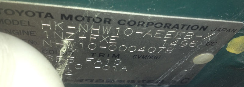

    Well my car is NHW10 and as far as I know, this car was never exported to US and so to say in any other countries. All the printing are in Japanese. In New Zealand, they have done some direct import and this is how this car landed here.

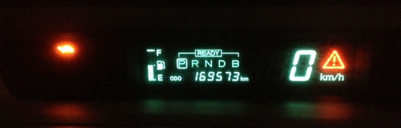

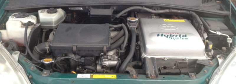

    Here is the little turtle I was talking about. It happened again last night (the engine was not overworking but just the little turtle sign on the left)
    Here is the details of the car. Sorry this is the best I could do.
    Also front of the car.

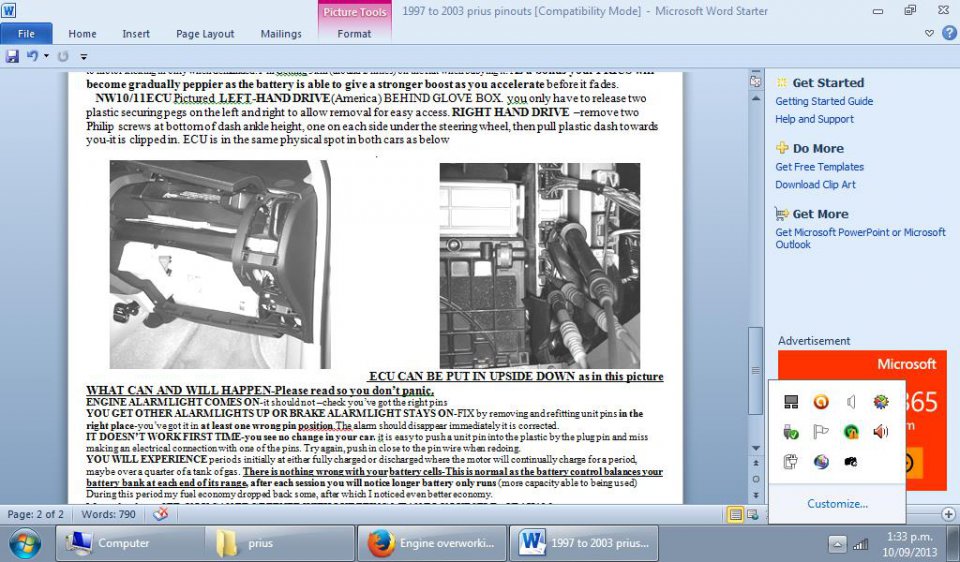

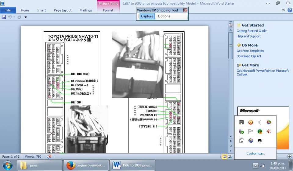

    If you are electronically minded,it may be worth considering placing a diode across the radiator Temp inputs on the motor controller.The orientation does not matter,nor will it stop motor over temp alarms.In many priuses that don't get much low speed or long runs it is not unusual for the battery to obtain a memory effect due to the initial charge on start-up and lose battery capacity.This diode fools the motor into considering it is hot and stops the motor kicking in on initial start-up,until battery voltage drops.This forces the battery to be used.
    My prius NW11 has 285K on it with this configuration and runs fine,with only one cell having died at around 250k after car left sitting for 6 weeks.I changed it out as a pair.I still get 20-22k/ltr (around 60MPG imperial not US)
    I did this for my wifes ex husband's 1998 Prius and that allowed the battery to regain enough capacity by being forced to run on it without the motor running on gas by deliberately crawling on battery power until the motor kicked in and then foot off the accelerator until motor stops charging battery and accelerate until the motor kicks in. Accelerate gently-then foot off over and over again
    That got rid of the turtle and returned a rather dead battery to a usable condition over a year ago after doing this for around half an hour,each time the motor starting to charge the battery closer to the turtle coming up,until it bet it.It is still running quite happily without seeing a turtle since.
    You may however have a dead cell rather than a capacity restricted battery pack.
    The pin outs are exactly the same on the NW10 as the NW11
    [​IMG][​IMG] [​IMG] [​IMG]
    CLIPS on RIGHT OF ECU UNIT CLIPS ON LEFT OF ECU UNIT
    S See the clip and groove instead of pin NOTE the groove on the otherside
    On the clipside of the plug in picture. Of the plug in picture
    SOME ECU’s HAVE BEEN INSTALLED UPSIDE DOWN that is why you have an inverted diagram as well
    USE PLIERS TO PUSH PINS IN BACK OF THE PLUG BY EACH WIRE
    PUSH HARD UNTIL THE UNITS PINS PUSH IN ONE AT A TIME.
    Pins 14 & 22
    As shown and reinstall the plug
    NW10/11ECU Pictured LEFT-HAND DRIVE(America) BEHIND GLOVE BOX. you only have to release two plastic securing pegs on the left and right to allow removal for easy access. RIGHT HAND DRIVE –remove two Philip screws at bottom of dash ankle height, one on each side under the steering wheel, then pull plastic dash towards you-it is clipped in. ECU is in the same physical spot in both cars as below
    [​IMG] [​IMG]
    ECU CAN BE PUT IN UPSIDE DOWN as in this picture
    WHAT CAN AND WILL HAPPEN-Please read so you don’t panic.
    ENGINE ALARM LIGHT COMES ON-it should not –check you’ve got the right pins
    YOU GET OTHER ALARM LIGHTS UP OR BRAKE ALARM LIGHT STAYS ON-FIX by removing and refitting unit pins in the right place-you’ve got it in at least one wrong pin position.The alarm should disappear immediately it is corrected.
    IT DOESN’T WORK FIRST TIME-you see no change in your car. it is easy to push a unit pin into the plastic by the plug pin and miss making an electrical connection with one of the pins. Try again, push in close to the pin wire when redoing.
    YOU WILL EXPERIENCE periods initially at either fully charged or discharged where the motor will continually charge for a period, maybe over a quarter of a tank of gas. There is nothing wrong with your battery cells-This is normal as the battery control balances your battery bank at each end of its range, after each session you will notice longer battery only runs (more capacity able to being used) During this period my fuel economy dropped back some, after which I noticed even better economy.
    Best of luck

    pic 1.jpg pic 1.jpg pic2.jpg hope these pics fill the holes in above-not so computer savvy as to get it all up at once.
    Graham
