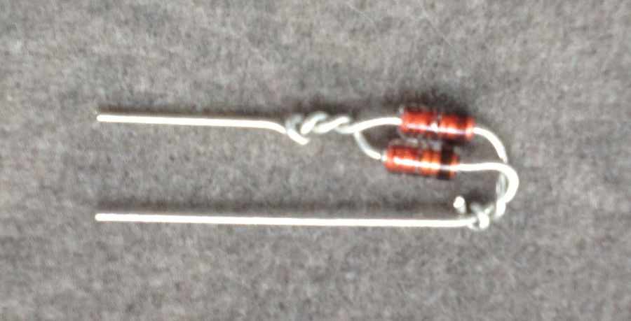

    You need to use 2x signal diodes in parallel as the circuit caries around 20-30ma from memory and most signal diodes aren't good for that continuously.
    The .2v across the diode is the important factor in diode selection.

    Indeed had a trip to Graham's place. Wonderful knowledgeable man. He in fact connected the diodes (in parallel) in my car. Here is the pic of the diodes.
    Many thanks Graham for all your effort and help.
    Over the weekend I will take some more pics of the attachment of the diode in the actual console and post it here. So watch this thread.

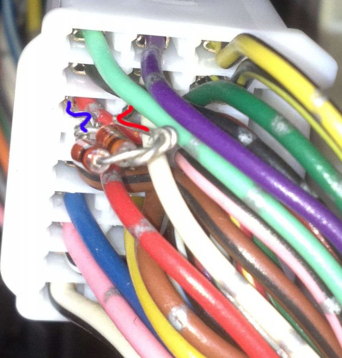

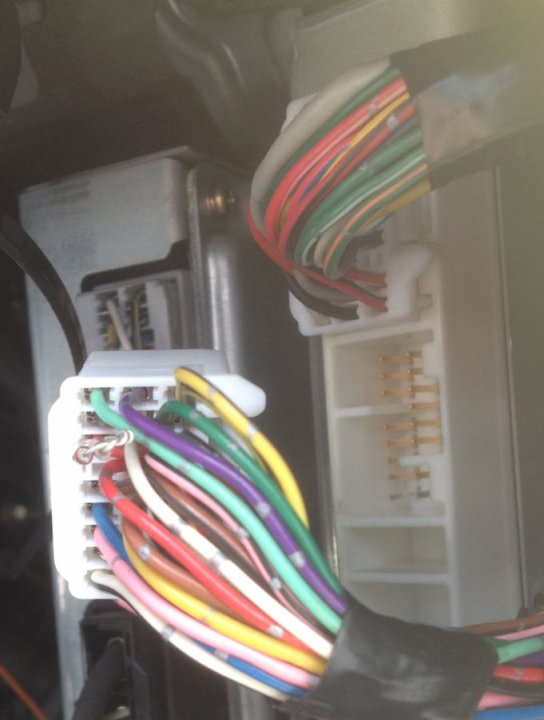

    OK here are the pics of the current diode set up in my car. Please note this a Right Hand Drive car. So if you are driving a Left Hand Drive car, do the required adjustments.
    You need to open the cover under the steering wheel. There are 2 screws underneath. You also need to unscrew the front bonnet opening latch.
    Then look inside and take out the 2nd plug from the top as shown.
    Diode is already attached. Here is a closer view with connecting pins marked (blue & red).
    Hope this is quite clear to everyone whoever wants to use this modification. Thanks to Graham once again. He did it for me.

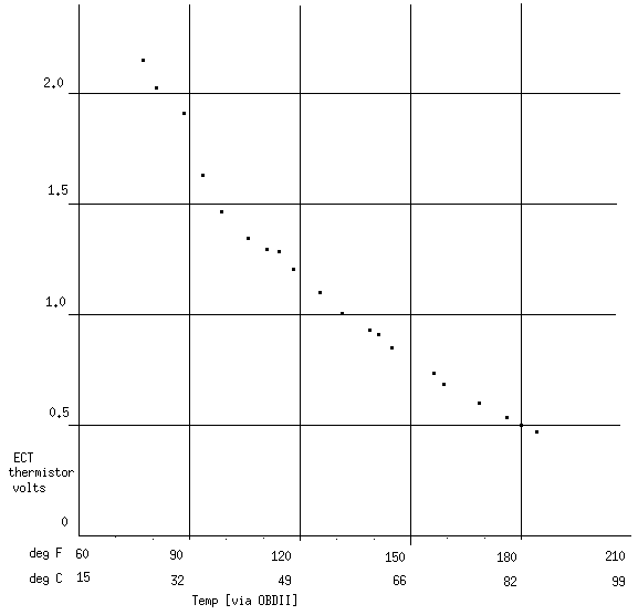

    First I want to thank you for the details about New Zealand resources. However, I wanted to add some details about the diodes:
    A typical silicon diode has a 0.7 V forward drop. What this means is if the voltage is higher than 0.7 V, the diode conducts and nearly regardless of the current, the diode will sit at 0.7 V. Now polarity is important because reverse biased, the diode will not conduct.
    The ideal configuration is to alternate the signal diodes so if one does not conduct, the other will. In effect, it clamps the voltage a 0.7 V in the engine thermostat temperature-voltage curve:
    Source: http://techno-fandom.org/~hobbit/cars/ect/ (and others)
    Because of the parallel installation, the signal diodes will shift the indicated engine temperature up but stop working as it reaches higher operating values. The problem are those of us who live where the temperature reaches freezing. If the engine is too cold, the diode hack can lead to the engine stumbling and dying.
    Now if I were doing a strictly analog version of my microprocessor based hack, I would design a long RC time constant base circuit (i.e., big cap, high resistor) that feeds a signal transistor base through a signal diode. The long time-constant would be in the order of 60-120 seconds to enable "closed loop" mixture control from the O{2} sensor operation before enabling the transistor so the engine coolant can reach a stable operating temperature. But I kinda like my microcontroller hack.
    My hack measures the temperature and if too low, leaves the bias out until the engine coolant reaches 30C. But it also monitors the engine cool-down when in freezing winds. So instead of letting the engine start upon reaching the lower 60C, it lets the engine cool even further but not below 30C.
    The diode solution works great in moderate, non-freezing weather. But in colder weather, it makes sense to have a driver accessible switch to disable it if it is too cold.
