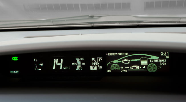

    She's got about 135,000km.
    No, the car doesn't accelerate. When you release the gas pedal it slows down but you can hear the RPM staying high... and then it drops. If you look at the picture below, where the MPG 100-50-0 gauge is, mine looks like that when the car is idling. Then the bars come down with maybe 3-4 bars showing. Normally, when idling, I would not see any bars there.
    By the way, this is not my car model. It's an image I took from the web.

    Maybe a hybrid battery problem? High revving and poor fuel economy.

    Houston, TX
    I agree with Mendel, sounds like a weak traction battery to me. It would help if the OP would post a actual pic of the HSI display of his car while it is doing what he describes. If it is the battery, there are alternatives. Still not enough data to really diagnose it properly here on PC.
