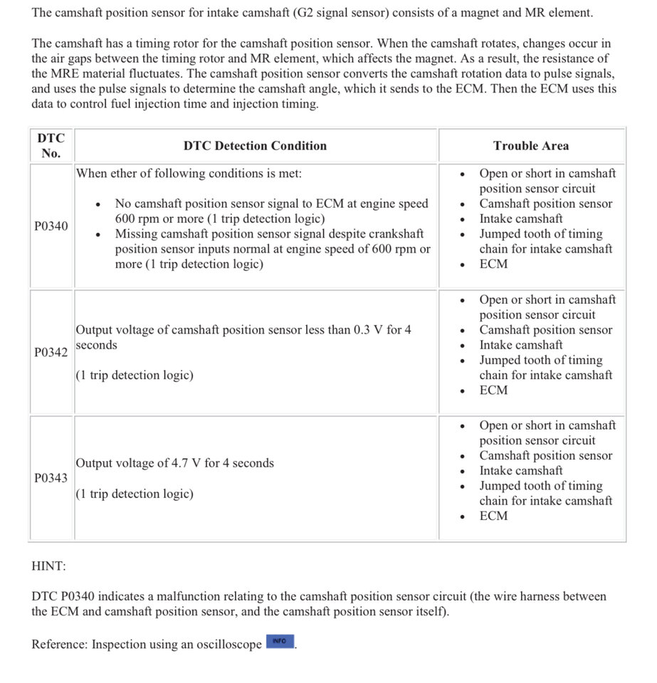

    It would help to know the code. However to check for an open you measure each wire for ohms from one end to the other with the ecm disconnected and powered off. Typically you want 1 ohm after accounting for meter lead ohm readings by themselves. You then check each wire to chassis which should be higher than 10k.
    See attached

    I suspect you don't have an "open" cam sensor based on your voltage reading changes, even though they were not exactly what the manual suggests.
    These three codes each have one possibility for an open circuit but have other options for mechanical timing issues, which are more common.

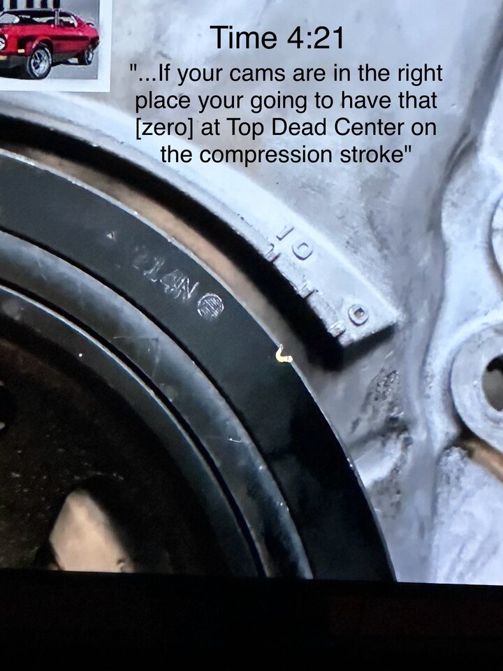

    Okay, this is interesting and I'd appreciate understanding what's going on here if anyone can explain it to me. I missed the step of lining up the mark on the harmonic balancer with the zero mark on the timing cover. I did line up the marks on the timing chain with the intake and exhaust cam marks as well as the mark on the crank gear inside the timing cover. Turning the intake cam until the marks line up again, it appears that the mark on the harmonic balancer is retarded by about 1/6th of a turn relative to the mark on the timing cover. I'd swear the mark on the gear under the timing cover lines up with the timing chain, I checked repeatedly before reassembly. Was I wrong in thinking that the mark on the crank gear corresponded to the 0 mark on the harmonic balancer? Does that matter for timing purposes if the marked links on the chain all line up where they're supposed to per the video that rjparker posted?

    The crank gear and harmonic balancer are keyed together. You do have to be tdc on the compression stroke.
    It may be worth the effort to pull the timing chain cover.

    Pulled the cover. Getting fairly fast at this, so that's an upside. I think the timing is correct, please verify if you could. I lined the harmonic balancer up to the zero mark and then pulled the timing cover. Here are pictures of the timing chain positions.
    There's a ratio between the crank and cams so all that turning the crank a few degrees to match it up to the zero mark did was to put the intake cam exactly at the 2 o'clock position, where it's supposed to be, and to put the exhaust cam at the 12 o'clock position, where it's also supposed to be. At least per that video you posted that I was following.

    Looks good now.

    I didn't change anything, other than rotate the harmonic balancer forward a few degrees to the zero mark before pulling the timing cover. Whatever the problem is, if this looks correct it isn't timing
