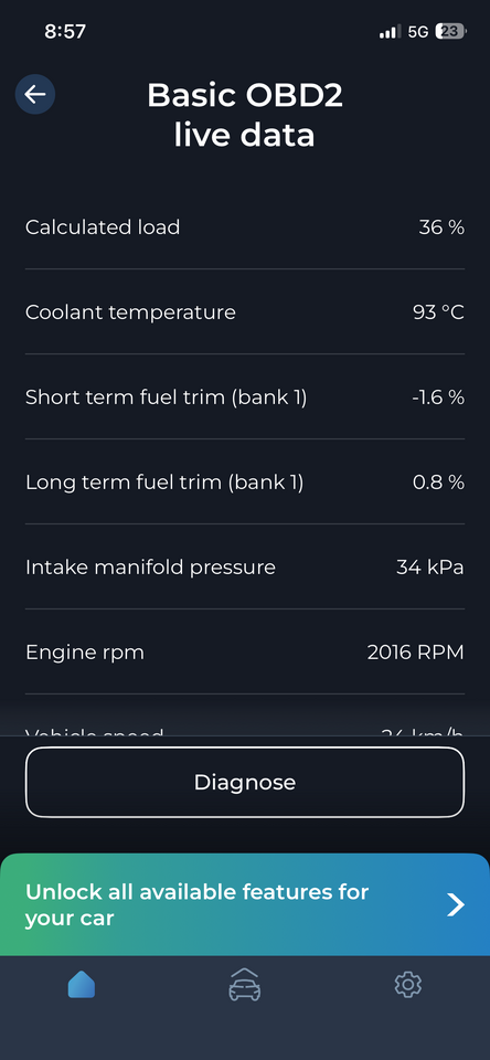

    No, I monitored via Carista app and it's <95 degree celsius, never gets to 100 which is when the symbol do show in dashboard. So i am trying to change the block 10 battery, in other to check if that might be the issue.
