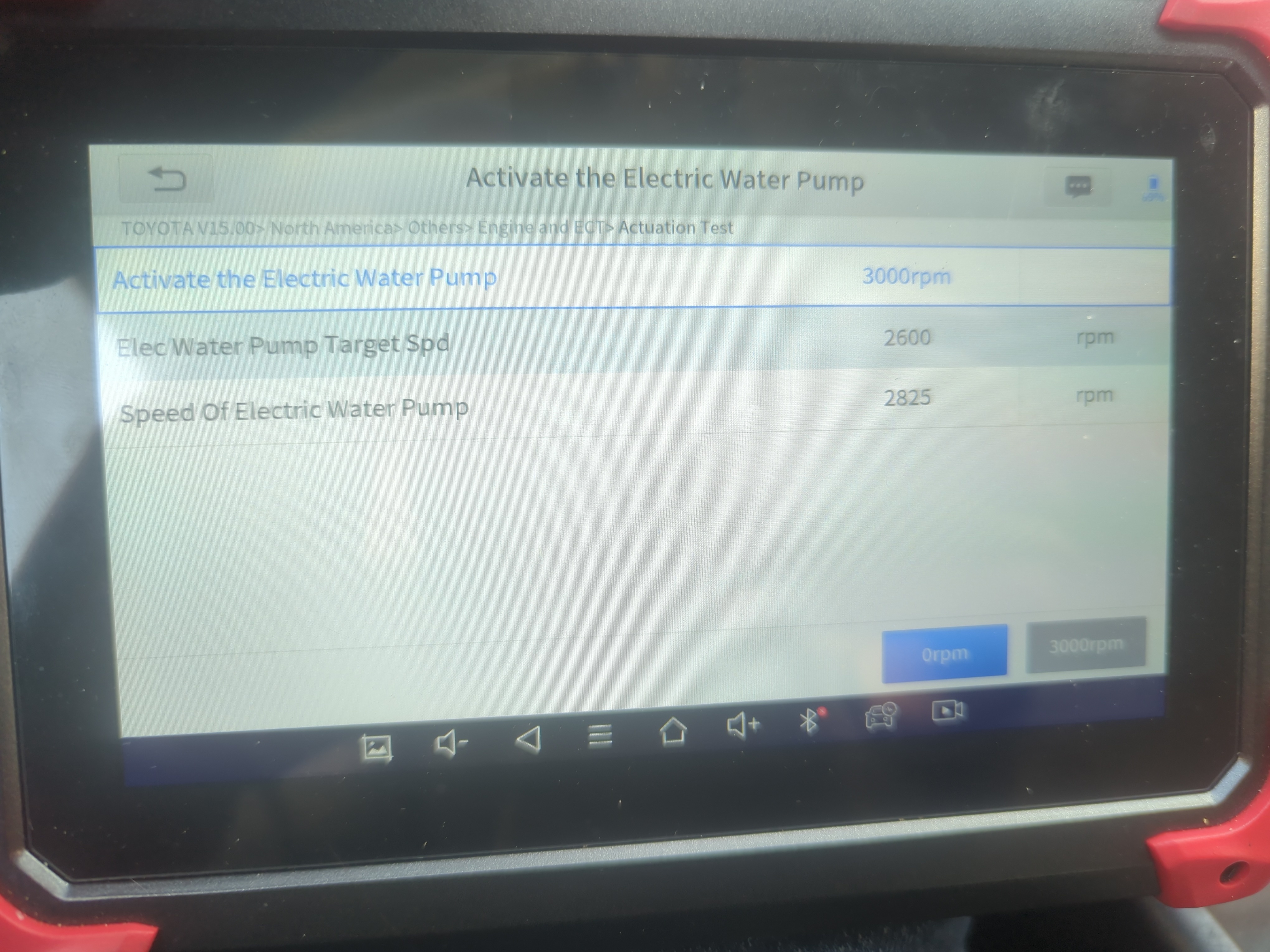

    Guessing it's the water pump but could use a second opinion. I do have a scan tool which may be able to actuate the pump. If others are interested, I can do a teardown on the part when I pull it. Also does anyone know the best source for Aisin pump? Thanks

    That would be my go-to resource. Have the car IG-ON but not READY, turn the pump on and off with the scan tool and see if that's the sound. Do that, and you can tell us the answer instead of asking us.

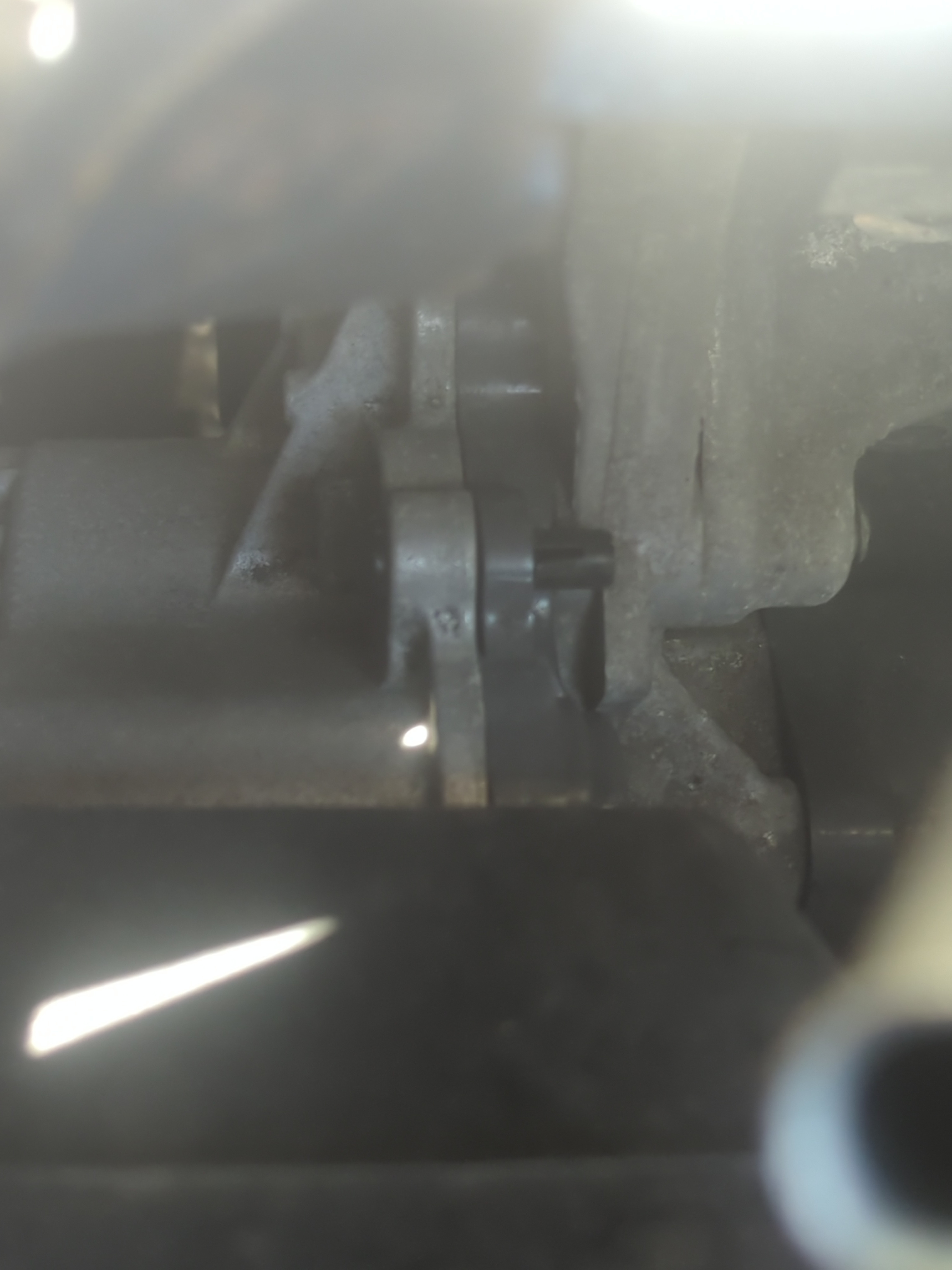

    I got the inverter pump done accessing via the wheel well and jamming my arms down past the inverter. Pretty tight in there and I did remove a few inverter retaining bolts and raised it up a bit. Not fun, but I had no interest in pulling that inverter.
    Not a great shot, but I'm thinking the water pump has been done at least once.

    You should be able to put a mechanic stethoscope on that pump while engine is running or not and hear it . Usually impeller peeling

    I figured out the tool menus and got some good data. It's looking like the water pump is OK. Onward. For other forum members who were curious what speed the pump runs, it appears to be 3000rpm. And the ECU does seem to track the actual speed.

    When you pop the water pump off and take the three bolts off the back or four and and pull plastic cover up see impeller issue sold on Amazon 34 bux .mag drive usually body is fine

    The pump is variable speed and the ECM does change the RPM target in normal operation depending on conditions.
    3000 RPM is just the one fixed target speed you get when you turn it on from the scan tool.
