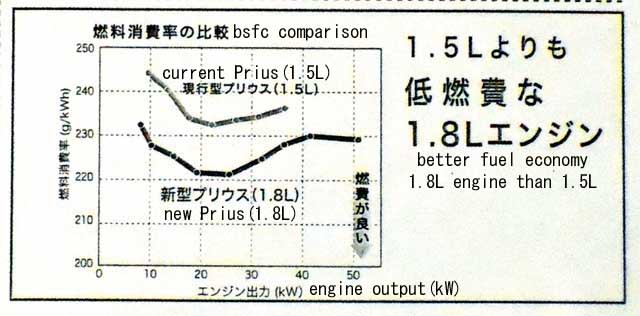

    I have had a Gen 2 and now a v, but not a Gen 4 or Prime, so this is true for me, and I have no reason to suspect it is not true for you:
    The CVT really works, there is no link between RPM and speed, or pedal position. The computer picks the RPM it thinks best suits the conditions. 60 MPH might be 1400 to 2400 RPM on the level. (battery charge, temperature, wind speed and direction, precipitation all change RPMs even on the level. Elevation changes alter it even more.)
    Redline for my v seems to be 5200, (the Gen 2 was 5000) mostly going up hill at highway speeds.
    The CVT does an odd overdrive, called heretical mode, to lower RPMs and increase throttle opening so the throttle plate is fully open and not blocking air flow. (so it lowers pumping losses, similar to a diesel) So I see the engine running at the efficient RPMs even under full throttle. The low point is the most efficient range. (this compares Gen 2 to Gen 3)
    Heretical mode makes Motor/Generator1 a motor and uses M/G2 as a generator. Normally M/G1 is the generator and M/G2 is a motor. In Heretical mode, the engine can push against M/G1, slowing it down while still allowing full throttle.
    Again, when going uphill, you do run closer to redline.
