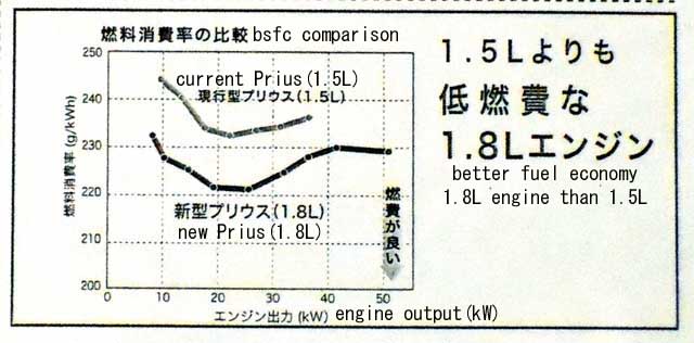

    I couldn't read the description on the Y axis even after zoom in so I looked for other clues in the the graph and descriptions. There it was in the graph title "bsfc comparison" and here's a good description of what bsfc is. http://www.hotrod.com/articles/ctrp-1109-brake-specific-fuel-consumption/ by Jim McFarland
