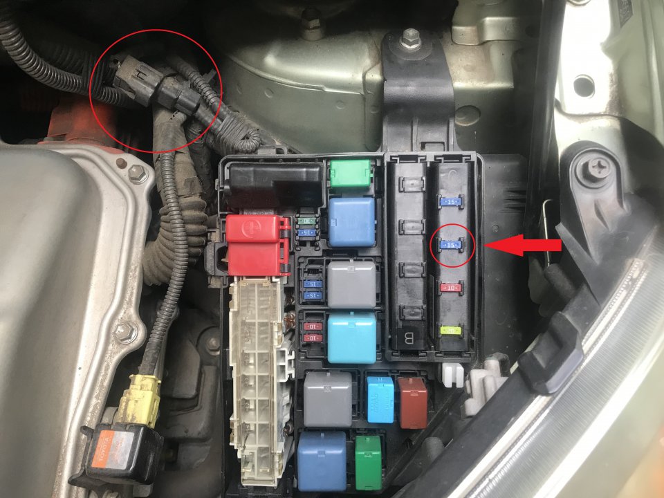

    I was driving on a neighborhood street, a normal day, without cold, heat, rain or snow, and the vehicle stopped. First time something like this has happened to me. There was a slight smell of burning. Tried to start it again and nothing. No ready, no gear position indication, intermittent fuel gauge (I knew positively that the tank was almost full), no red triangle, no alarm, nothing.
    I disconnected the 12 V battery and reconnected it after 5 minutes, I even disconnected the main battery, and nothing, everything was the same.
    I tried looking for information here and it was the most frustrating thing that has ever happened to me.
    The next day I started checking the fuses one by one until I found the AM2 15 Amp fuse blown. This fuse, in addition to powering the inverter's coolant pump, powers a good part of the computers when the car starts up.
    Luckily for me, the replacement fuse I had was 20A, so I put it in and it allowed me to see smoke coming out of the area where the inverter coolant pump is. So far I did not know if it was the pump or some wiring. The 20A fuse held without blowing.
    I began to disassemble everything necessary to be able to extract the pump and when I was able to get to it I saw that there were ashes in its lower part. Here is the culprit. I electrically disconnected the pump, put the vehicle on and everything went back to normal. I even started it for a few seconds to check that no other fault appeared and the car started without problems and without indicating any fault.

    I can see why you didn't quickly find the many threads here about that somewhat common issue: it's common for Gen 2! (In fact it's so well known for Gen 2 I immediately thought that's what you had when you reported it.) You might be the first one reporting it in a Gen 1. If you had posted in a thread describing the specific symptoms you've just described here, there was a chance the professional reviewers with no idea what they're talking about might have made the connection to the many Gen 2 threads we've got describing that issue.
    For Gen 2
    For Gen 2 it's well documented:
    For Gen 1
    For Gen 1, there isn't the same handy connector near the fuse box to disconnect the pump. You just have to unplug the pump itself.
    So I guess now we need a picture locating the AM2 fuse for Gen 1 also. :)
    It would also be good to start a Gen 1 thread specifically about this; it will be easier to find there than here, with just a vague "engine will not start - weird issue" and three people tagging on at different times who probably had three different problems.
