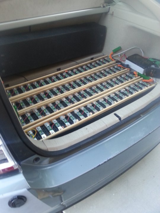

    I bought my aftermarket Prius Plug-In conversion kit, or add-on battery pack, from Plug-In Supply about 1.5 years ago. I did the do-it-yourself method to save on $$$. I had some problems at first since I'm not an amazing engineer. Soldering is not my forte. I killed a few boards but the owner helped me out and got me up and running. Still it was worth learning how it all works by putting it together. I spent probably 4 nights assembling the battery pack and then 2 weeks to do the car install. I got a 10KW system in my car working within two months of purchasing and have been saving on gas. I get over 85+ MPG and I am a VERY aggressive driver in CA. Sometimes I get over 70 miles in range on the 10KW system because I think the cells I got made the pack around 12kW. When I drive around town in the suburbia it is 100% EV and I can get 150+ MPG. The owner, Robb has helped me on the phone many times and is very knowledgeable about mechanical engineer, batteries, and his proprietary system. I am glad I went with Plug-In Supply and not Engineer. I would suggest you take a look at the plugin supply website before going with Engineer. I think Robb still does FREE TEST DRIVES personally, if you are inside the USA.

    Pics or it didn't happen.... I'm skeptical... the LEAF with a 24kwh battery gets around the same range...

    oh crap, i can't do math, or can i?? here's the calculations ...
    76 cells Sinopoly 40ah = 3040 amps * 3.2 V = 9728 watts ~= 10kW
    but when I measure the cells during a charge they go up to 3.6 V (where i live) so if you calculate all full charge and not some average bell curve (3.2) then you get...
    76 cells Sinopoly 40ah = 3040 amps * 3.6 V = 10944 watts ~= 11kW
    sorry, i mispoke about the 12kW, but I think the Chinese battery manufacturing is not 100% exact science and because I'm getting more that 70 miles, I believe they are not 40ah, my guess is 42 ah, and if they were the math would be:
    76 cells Sinopoly 42ah = 3040 amps * 3.6 V = 11491 watts ~= 11.5kW
    then you have to calculate the number of watts per mile, and i think for my driving i'm getting about 160 watt/mile
    11491 watts / 160 = 71 miles
    i don't get that all the time, sometime i get only 50 something miles on a full pack and that would mean i'm using 200 something watts / mile (WPM), not words per minute for all you speedy typists.. i think i said sometimes...
    i didn't mean to make that "embellishment", it's more like 11.x kW, but we can call it 10.5kW if that makes you feel better. if you want to research the sinopoly they have a chinese website, use google translator and look for SP-LFP40AHA on sinopoly battery website on the product batteries page.
    also, i don't have a way to calculate the watts / mile yet, but i'd like to find a way or make a way so i can track this. Instead of MPG, we should be looking a WPM (watts per mile). i'm thinking about making some arduino or raspberry pi mobile app to track the data i want using sensors and sending over wifi to mobile device... like the torque, but for my BMS and EV usage...
    and pictures of my pack for all the non-believers...
    formula likes this.

    The embellishment in question was your miles per charge, not your pack size or that you had a pack. I've seen many conversions on Gen 1 and 2 Prii, but none with your range from such a small battery. Either those are the most expensive batteries ever (to compensate for the energy density), or your entire trip is downhill.
