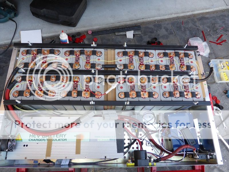

    so, Day two begins with bolting the cells together and installing the cell modules...
    here you can see all of the interconnects and cell modules installed.
    note that at this stage, the 2 sides of the pack are NOT connected.
    the link at the far right side is NOT connected. this was done for safety reasons, so there is less chance of shorting anything and also less chance of a shock should you accidentally touch both side of the pack at the same time....
    you can also see the soldering iron at the ready for the next stage...
    all of the cell interconnects are soldered together in series, with a 100ma fuse in the center of them. this is the signal line that the cell modules use to communicate with the BMS. (the thin yellow wire)
    the BMS turned on for the first time :)

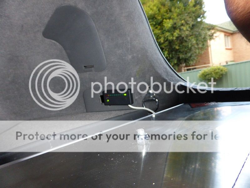

    here you can see the SOC meter... this will be relocated up the front near the driver at a later date.

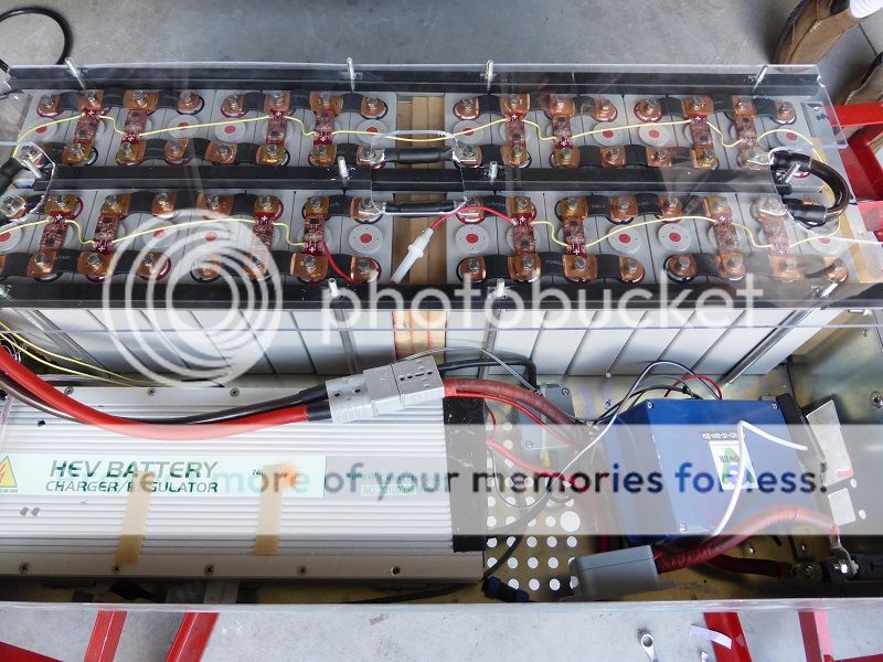

    here you can see the mini latching relay that was used to replace the contactor.
    note the size difference !
    the contactor would have worked, but then i would have needed to use a automatic precharge circuit of some kind.
    as we tested the inrush current of the DC-DC converter, and it was significant. too much for the long term life of the contactor.
    so we decided to investigate further the use of the 2 wire control from the DC-DC converter.
    we went to the local electronics retailer (jaycar) and bought the small latching relay.
    Vincent was able to disconnect the latching contactor from the BMS and wire in the mini relay, but in the opposite connections to the original contactor.
    the contactor was supposed to be closed when the BMS was on and happy, and open when the BMS is off or tripped.
    we needed the opposite behavior. the mini relay would need to be open when the BMS was happy, and closed when it was not happy.
    with that sorted, we tested the operation of the BMS and by simulating a low cell (by disconnecting the cell module line) the BMS started beeping, and 30 seconds later, it shut off the DC-DC converter and the red light on the enginer switch came on.
    we also tested what would happen if the BMS was turned off while in operation. in this case, the relay also closes and the red light on the enginer switch illuminates.
    the downside to this control method is that there is ALWAYS SOME draw on the pack even when the system is off.
    this is very minor. it's only the leakage current required to keep the large capacitors inside the converter topped up.
    this is exactly the same method as the enginer BMS used. it had no pre charge circuit, as the caps were always energized.
    so if the system is not going to be used for a month, it will need to be plugged in for a few hours.
    the alternative is to flip the 100A breaker on the side of the box, as this will also shut off the entire system completely, but then there would be a very large spark inside the breaker when turning it back on (ask me how i know this ?)
    here you can see the 4.5mm sheet of clear polycarbonate that was used to stop any potential contact between cells and the lid of the box...

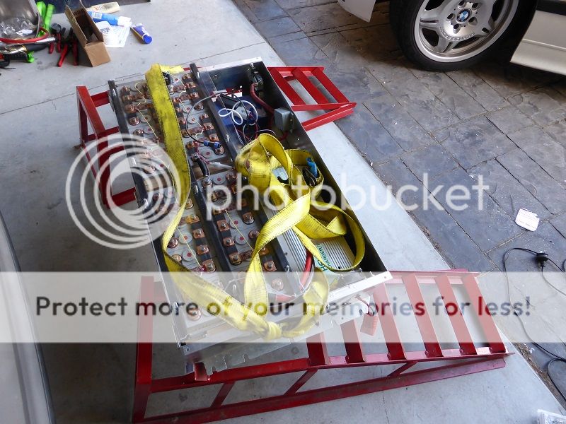

    here we are getting ready to hoist the box into the car...
    here you can see the box in mid air suspended by the hoist. we were testing the charger and whether the BMS would control the charger as it was supposed to. we also had a clamping type meter on the output to the battery pack. it was charging at the full 25A as expected...

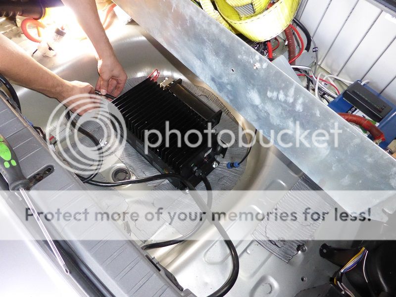

    here Vincent is tapping into the AC line into the charger to power the cage fan that we bolted to the charger.

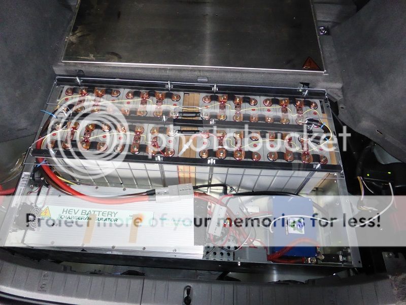

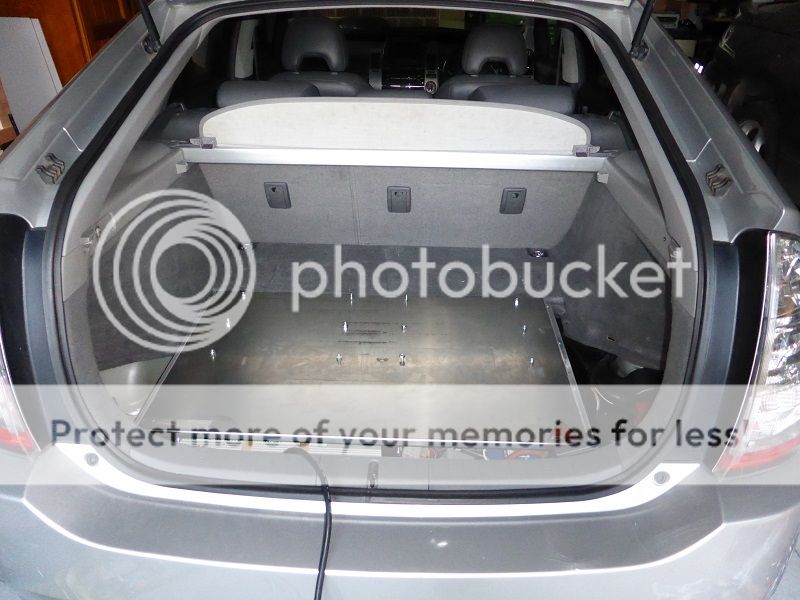

    here it is lowered into place in the trunk.
    all bolted in and buttoned up.
    the bolts that protrude through the top of the box are part of the new battery hold down system.
    the threads will be cut back at a later time, and a suitable piece of carpet will be used to cover it all up.
    the new box height is about 70mm or so higher than it was before, so the original floor piece will no longer fit.
    temporary home for the SOC meter. ill move this later, up front somewhere.

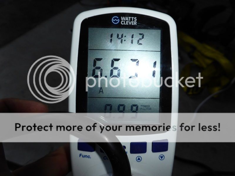

    plugged into a watt meter and charging nicely. drawing 6.6A at 240v.

    i have 640km on the tank and still showing 2/3 full.
    Jason.
