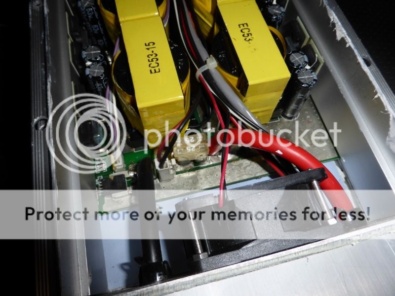

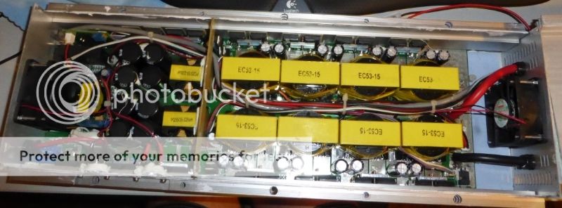

    the first option didn't work out, and i had help today to remove the converter from the car.
    im taking it to the repair shop Monday morning.
    while it was out of the car, i took the opportunity to open the lid and have a quick look inside.
    my untrained eyes couldn't see anything obviously melted / blown up.
    & nothing discolored or obviously out of place...
    i also tested all 4 of the fuses near the input to the converter.
    all 4 are ok, so it's not the fuses....
    i have taken a few pics for those that might be interested.
    i will report back if the shop is able top repair it or not.and how much it costs to fix....
    Jason.

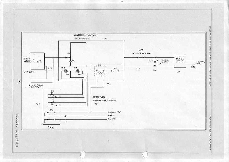

    The front mounted switch is not prone to failure but the design of using a RJ45 plug is questionable as sometimes they do not make good contact and are prone to vibration as reported by some Enginer users in the past.
    See wiring diagram below. If the green LED works then it generally means the DC converter is working.
    When bench testing the DC Converter you need to connect a 2000 watt load across the output to verify it works. Verifying it works under no load does not prove much.

    Thanks for the diagram. I'm sure it will prove very helpful.
