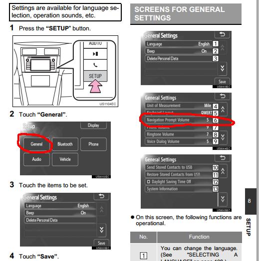

    ENTUNE RESET PROCEDURE (w/ Entune Function)
    DO THIS AT YOUR OWN RISK!
    Reset the extension module.
    (1) Display the "Navigation Prompt Volume" screen.
    (2) From the "Navigation Prompt Volume" screen, touch the corners of the screen in the following order: Upper right → Lower right → Upper right → Lower right → Upper right → Lower right. [​IMG]
    (3) Select "General" from the Entune system status display screen. [​IMG]
    (4) Select "Reset Extension Box" from the "General" screen, delete all personal data from the head unit.
    HINT:
    • This will remove all personal data from the head unit.

  8. wmo168
    wmo168 Member
    Apr 9, 2013
    239
    South Florida
    Where is NAVIGATION PROMPT VOLUME screen?
    :confused: :confused: Yes there is, SETUP -> GENERAL -> NAVIGATION PROMPT VOLUME, on that screen is how you get to the special menu. See the instruction below.
    From the Prompt Volume menu you hit the BLANK SPOT from what I said in the 1st post ... Because the service menu is HIDDEN, it will bring up once you follow the steps.
