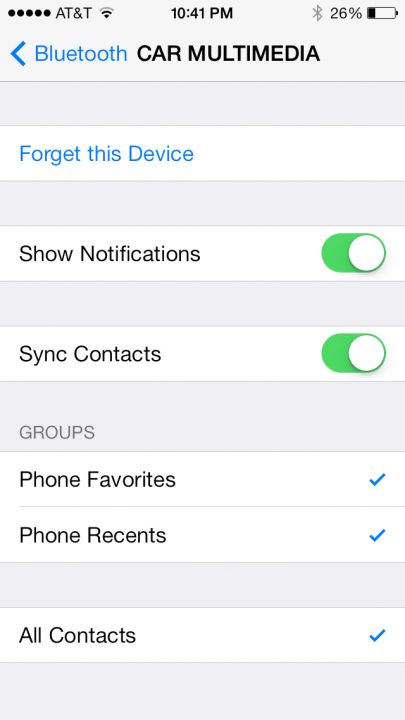

    Ha, we actually just got my wife's 4s replaced as she had that exact issue after upgrading to iOS7. Wifi and bluetooth both stopped working. Replacement is ok so far.
    I actually meant just tethering as in the sense of connected to entune via the usb cable. I don't have a tethering plan as it would cost me a bit of extra money every month and it wouldn't get that much use.
  3. Zephyr7
    Zephyr7 Member
    Nov 12, 2012
    301
    when one does a major OS upgrade, BT connection with the system may not work.
    One have to delete pairing and repair is all it takes to get it going again.

    If that was directed at me, the issue is more serious than that. Some users, my wife included, are finding that their 4s will not even allow them to turn on the wifi or bluetooth radios after updating. Factory restore does not fix the issue. Apple replaced the device under warranty.
