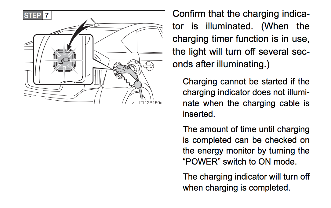

    I'm still very curious, why did the battery run down? I tried locking the car again as i normally do, and everything seems to be off, except the red blinking light with a symbol of car+key. I'm assuming it's an immobilizer symbol (as i read in other thread).
    If entire dashboard is off, no light is visibly turned on, no indicator is on, i guess the car is off.
