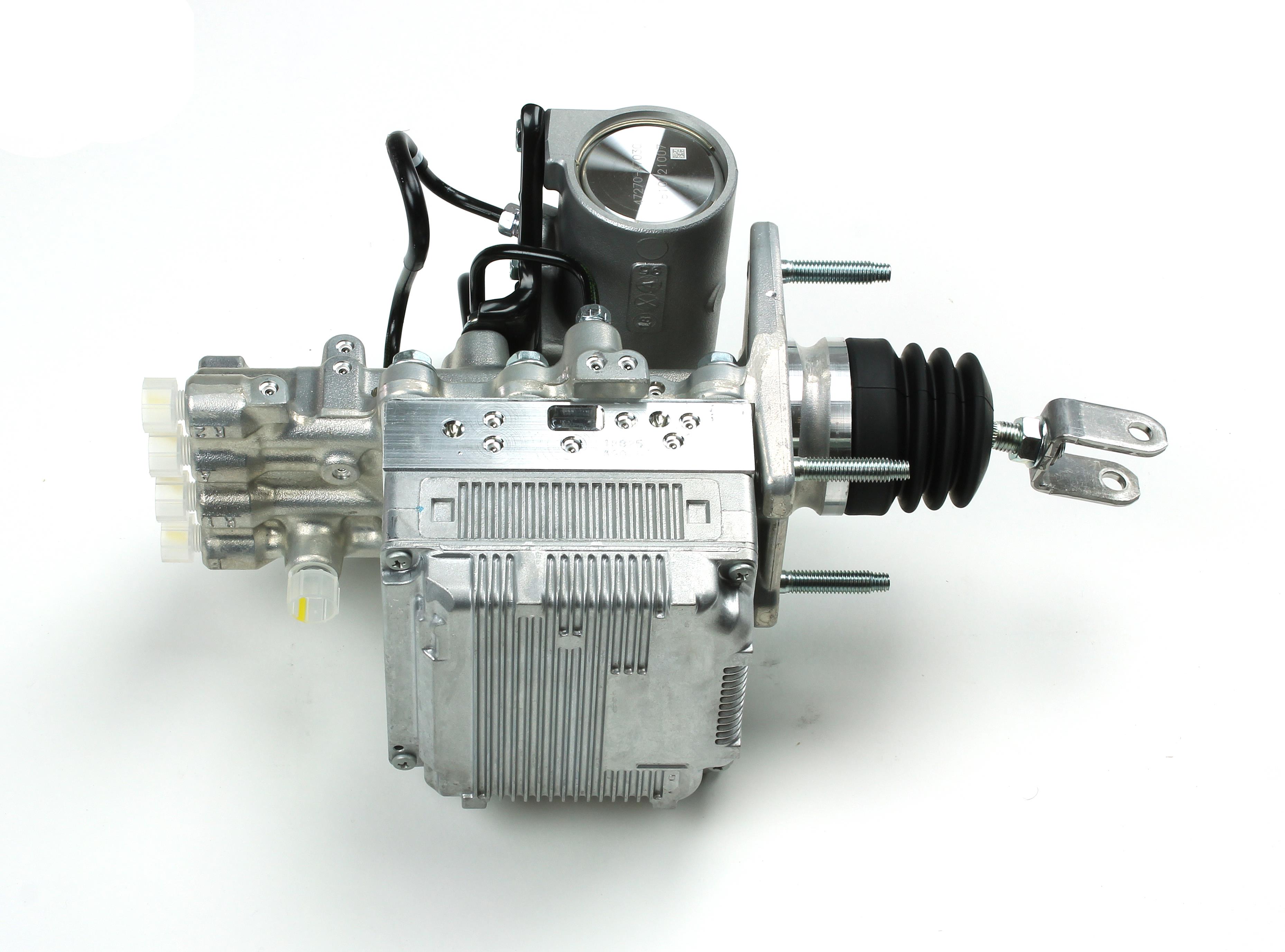

    If you end up taking the vehicle anywhere to have the codes read, do not allow anybody to clear the codes or disconnect the 12V battery.
    Reading the codes by yourself using the paper clip method is your best bet. If either C1391, C1252, C1256, or C1253 pop up, AND the mileage is under 150,000, you are in for a free repair courtesy of Toyota's ZJB customer support program.
    Judging by the video, in which the brake booster pump can be heard running every 2-3 seconds, it's quite likely there is an internal leak in the brake booster assembly. If your vehicle is covered, Toyota will also replace the booster pump for good measure.
