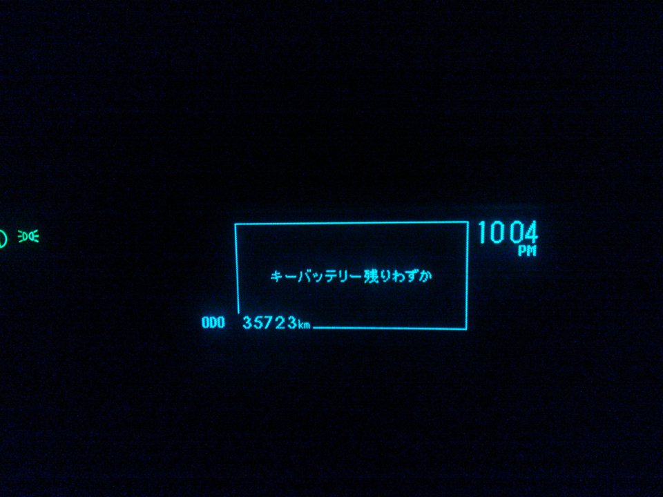

    i have a prius 3rd gen 2010 japanese for over a year now. no issues until abt 3 days ago i got an error msg in japanese with an exclamation mark, when i stopped the car. there was no issue when i started back on. since then the msg comes once in a while when i stopped the car. not every time i stop. pls see image for msg and help.

    Answered in the other thread posted in different section. (Replace key battery).

    I'm also having the same. Glad I found this first caz my agent had no clue of what it is about!
    Thanks experts :)
