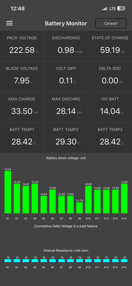

    I have reconditioned the HV battery thinking it was the issue, and Dr Prius reads the voltage properly with no issue.
    Any help will be appreciated.
