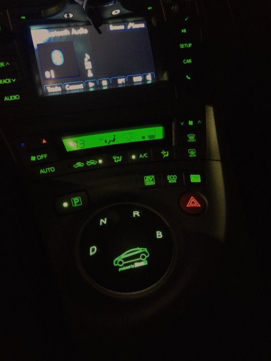

    After seeing the You Tube installation video confidence was no barrier. An actual short classic butter knife on the bottom left was easy to pull it loose and just continued on around to the left. came right off exactly as shown and it would have been 10 no more. Oops the 12mm nuts came loose and I had to walk ALL the way back to the cottage to get a telescoping mmagnet. A nut on the lower side dropped in a little opening. Suggestion to put painters tape to cover those caves.
    Pulled the shifter up and out feed the wire through, reattach the plugs, the three clips hold it perfectly. No code and the literature he sent did not mention pulling a battery cable. Dandy mod imho. No mention of how we can get to the color options. Stage 10 has nice marketing.
    He was following the FedEx tracking I guess and sent an email offer up any help at all, thank you, they want to maintain all A+ reviews etc.
    Seamless intergration the matte black goes well and the Prius pic is adorable. Had to put it in before we took the trip tonight.

    Eight days and 600 miles later and I do like his mod more than I thought I would. The fact that the stick is missing and the uncluttered look and feel should not be discounted. Would love to know if the "7 Color" option means the colored merry go round on the boot mode or as shown online there is a few more goodies for that $30 +/-
