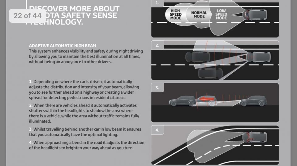

    According to this, the system has 3 different patterns.
    40mph is probably the limit for that low speed mode, and you are seeing that pattern switch. The low speed pattern could still be high beam when compared to traditional headlights.
    The US Vehicle Code is outdated. We can't get these advanced headlight systems because of that.
    The sooner you see something, the sooner you can react to it. 75mph is likely outrunning the low beams.

    Here is a possible explanation (similar to Trollbait):
    The AHS adjusts the brightness and illuminated area of the high beams according to the vehicle speed as follows:
    In French video is mentioned: ... "we have the maximum beam width for speed 15-40 km/h" ... "and the minimum width for 80 km/h and more" ...
    So, probably it works, just the illumination range is changing from the maximum width to the minimum one.
