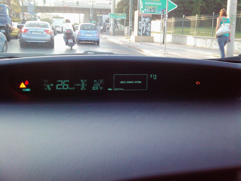

    THEY SAY IT WILL BUT I AM STILL WAITING FOR A DEFINITE ANSWER I AM STILL DRIVING IT WITH THE OLD BATT. EVERY TIME TE CHECK HYBRID LIGHT COMES ON I TAKE THE SMALL BATTERY TERMINAL OF TO RESET SO THAT THE ENGINE WONT KEEP ON RUNNING
    THERE IS A PIC OF MY DASH BOARD
