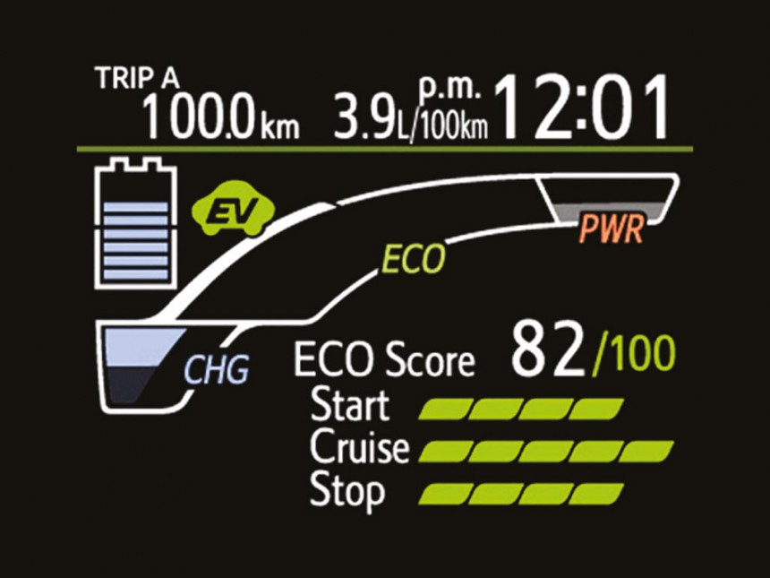

    in parking lot. :) or you can use it when you drive slow.
    basically you don't have the TURN ON the EV mode, you can use ECO mode or normal mode and keep the "Green bar" on the monitor below the "ECO" and it will only use electric motor.
    I find out you can use ONLY electric motor to keep the wheel rolling when you are going like 25mph to 40 mph.
    it is like
    1) stop
    2 ) you can accelerate to certain speed normally. (gas and electric motor will turn on)
    3) when you reach like 30 mph, then let off the gas. (you should see the "EV" come out on the monitor)
    4) then give a little gas ( make sure the Green Bar is below the "ECO")
    5) then it will keep going without using any gas until the battery charge is low
    I tried it today and I get 65MPG on a 35 MPH road. lol
