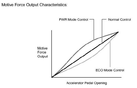

    Check the picture on post #7 on this thread:
    EV-ECO-PWR and NONE ? | PriusChat
    Note that at zero accelerator position (foot off the gas), the throttle is closed in all modes. At maximum accelerator position (floored), the throttle is wide open in all modes. The differences are at partial accelerator positions.
    This gives the perception of quicker throttle response in PWR mode at the expense of less fine control of the throttle opening at lower pedal pressures and more sluggish response in ECO. But in any mode, WOT demands all the power the car has.
    The Gen 4 may have totally different throttle maps, but it also has more actual horse power to work with, just as Gen 3 has more than Gen 2.

    Thanks for that really helpful chart, jerrymildred, and the link to the other thread. They both clarify a lot for me, and make sense. I'm glad to know there are reasons for what I'm feeling with my right foot :)
