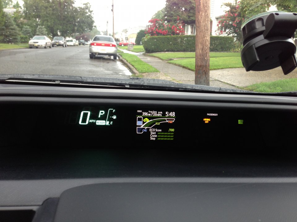

    17
    2013 Prius c
    Question: why my EV mode still on when i already park my car? Btw, i didnt press the EV button. Anyway, this is the best MPG i got so far for a trip!
  3. Species5618w
    Species5618w Member
    May 13, 2013
    140
    The stealth EV mode is on as the engine is not running.
