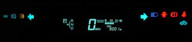

    For those lucky owner which have the EV swtich installed. Could you tell me where is the EV Indicator on a 2007 Prius please? A picture will be great. Also, any benefit that you can see with the EV Switch?

    If you are in a market that does not have the EV switch as standard (like North America, for example), you will not have an EV indicator - even when you install the switch after-market. If you DID have one, it would look like this (far right side).
    But you won't, so don't get all exited.

    Thanks, how do I know the EV Mode is working then?

    The MFD will tell you when it is enabled. Try doing a search and you'll find many, many threads on this topic.

    As Ari mentions, the MFD will notify you IF you have the screen set up properly before activation. After you've already activated EV mode, there really is no indication of it being on - execpt of course that you are now on electric motor only. You've just got to know when you hit the switch. There is a beep and notice when the car (automatically) goes OUT of EV mode, however. And there is a notice when you try to enter it at a time when the system will not let you (going to fast, or the car is in warm-up mode).
