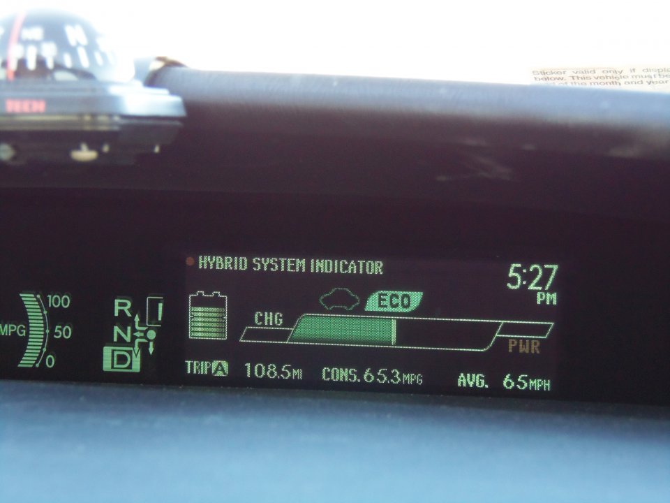

    What is the amp pull during the max acceleration in EV mode, when the HSI is maxing out the ECO area?
    The battery is listed as 36HP, but I suspect during this max acceleration it puts out more than 36HP, even just for a short period of time. Does anyone know for sure?

    The system limits battery current to protect the batteries. This means the maximum is a lot less than you'd imagine.

    36 HP is the instantaneous max power can be drawn from the battery.
    36 HP x 746W/HP = 26856W
    26856W / 201V = 133.6 A which is 133.6/ 6.5 = 20.6 or 20.6C of the rated C of the cells.

    Yes, a very heavy draw. It wouldn't allow it for more than a few seconds to protect the batteries. They are 6.5 A-Hr cells. If you purchased a 6.5 A-Hr NiMH cell you would find the max. current specified around 50 Amps. The Prius cells are a little special, with better heat dissipation, mostly due to their "prismatic" construction (rectangular vs cylindrical cells). They also have much better inter-cell connection devices, allowing less heating and more current. At any rate, heat is the enemy, and the Prius battery WILL heat up, especially at 100 Amps.
    You can test this by switching to "EV" mode and see it switch out to normal mode as soon as you get the current up (harder acceleration). It doesn't take much to cause it to switch. 36 HP isn't much when accelerating.

    The Prius 7.2V module is rated as 1300W/kg.
    NP2 battery module (in Japanese)
    So, the peak is 188 A.
    Anyway,
    JP PiP sales staff manual says the threshold battery power at the ICE kicking in is 38 kW on the PiP and 21 kW (EV switch on) on the liftback.
    So, the max amp is approx 104 A on the Gen3 Prius when EV switch is engaged.
    Ken@Japan

    I've seen mine at somewhere around 100-110 A, when going up a steep hill with a full battery. It was a little ways into the PWR bar. Most of the time, I don't think it'll go that high.

    I get a reading of just over 30 amps using the ScanGauge BTA (battery amps) when accelerating up to the mid-point of the HSI, just before the ICE kicks in. Is that what you mean?

    In "EV" mode under max acceleration when the HSI bar is all the way to the right, I've seen momentary ~100A. In normal mode when accelerating to get on the fwy Iv'e seen 150A.
