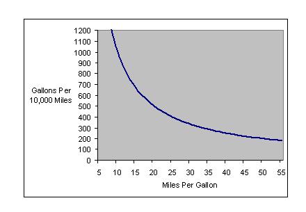

    Philosophe, while your math is spot on, you've over looked a few key points. A: while the high milage car only saved .2gal of fuel, it cost (@3.00 per gal) $16.67 while the SUV cost $30.33 for the same trip.
    B:Then there is the feel good factor for getting those extra 10 MPG in the high mileage car...$$$ priceless.:D

    If you take a look at the money saved with the 30 MPG SUV instead of a 20 MPG, vs the 60 MPG hybrid instead of a 50 MPG, the former saved more money...
    Of course anyone will agree that a Prius consumes less fuel than a SUV but that was not what I was trying to highlight. :rolleyes:
