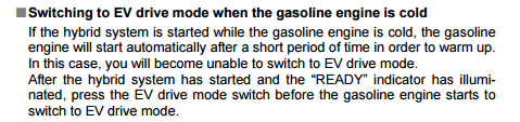

    From the 2016 Prius v manual:

    Update:
    I tried to activate the EV mode immediately this morning, with a mostly full battery, and was unsuccessful. Engine fired up moments later. Once warmed up, I could use it with the conditions I mentioned (sub 25 mph). As said by prodigyplace via the manual:
    It did say "Ready" even as I first started the car before trying EV mode and as I drove away.
    Side note. At one point, 15 minutes into my drive, I turned EV mode on at a red light, turned right and it deactivated at 10 mph "excessive speed" even though I was gently accelerating. Interesting.....
