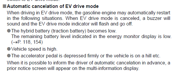

    I agree. I sometimes use EV at the end of my commute when I am on a private road (15 mph limit. 0.1 mile) and the parking lot.
    From the 2016 Prius v manual

    I use it usually at the end of my commute to boost my MPG. Since I know the gas engine will always run when I first start up, may as well use that to charge the battery. I get a consitent 44-48 MPG driving local trips (based on the display since start).
    It is just interesting that sometimes I can easily cruise along at 24 MPH in EV mode and others it kicks me out at 10 MPH no matter how gentle I drive. The indicated battery is usually high when I try EV mode.
