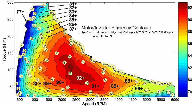

    Where is the motor's peak efficiency?
    I know a basic rule of thumb I once came across for DC ones is peak torque is at 0rpm with steady decrease as rpm increase, peak power is around 50% of the motor's rated rpm, and peak efficiency at 75% of rpm. I don't know how well that holds for the AC motors in BEVs.
    An electric motor is very efficient compared to an ICE, but it still has points in its output where it is best and where power output is better. That's why the AWD S gets a slightly better range and efficiency without changing the battery. The question is will the gains at higher speeds off set the overall losses of a 2 speed transmission.

    Efficiency of the 85d is less than 2% better than the regular 85. A transmission would drop that much or more. The 85d's efficiency also stems from better regen braking, while a transmission would not help at all. What the d gives you is better accelleration and top speed, a transmission can do that, but really isn't the model S fast enough, and you go to the P85D if you really want improvement. IMHO a transmission would only slow that car down.

    It looks like best efficiency of motor/converter is 92%, 7000rpm=60mph, and we should be in the 85% efficiency range or lower at 65mph. Say the transmission adds 3% more mechanical losses and could jump 65mph from 84% to 91%, range would increase 5.1% at 65 with the cruise on. I of course don't think the gain would be this big, and you trade off 3% lower range at all speeds bellow say 35 and do worse in the epa city and combined tests. For the range it would be less expensive to just make the battery a little bigger. That is why no one is really clamoring for this.

    Point is that there already are fixed gear transmissions in existing EVs, and multi-gear transmissions will be nothing more than clutch-sets to switch out one fix gear box for another. Fix gear box which is optimized for specific range, so you would get your 92% at 60mph and at 25mph.
    There are no mechanical gains but there are no additional mechanical losses either, so from that point it is a zero sum.
    From electric motor point of view you have 2 optimal speeds, so overall efficiency goes up.

    AC motors have a much flatter efficiency. Power reaches peak quickly and the maintains it. Torque is virtually instant and then maintains it, with a slow decrease at high speeds.
    They are much more efficient over the power range EVs are typically using.

    Yes, you are getting 92% at two speeds. But you are getting 92% of a lower number in both cases because you added extra overhead (weight) to get it.
