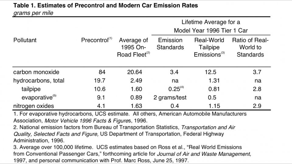

    Doubling the fuel economy would have reduced emissions by 50% per mile. A 1970 car emitting 20g per mile of unburned hydrocarbons would be reduced to 10. But doubling fuel efficiency is a hard challenge even today with hybrid powertrains.
    By contrast, the EPA mandated emission controls reduced unburned hydrocarbons by at least 10-20x under real-world conditions. The auto industry lobby was claiming an overall 96% reduction in regulated emissions between 1965 and 1995 based on EPA emission standards and those standards have been tightened significant since then.
    Carbon monoxide and nitrous oxides have been reduced by at least 4x. I remember what pre-control tailpipe emissions smelled like -- reducing that by 25-50% would have still smelled pretty bad. By contrast, tailpipe emissions from a modern car are barely perceptible.
    This handy table is from a report published in 1995.
    http://www.ucsusa.org/assets/documents/clean_vehicles/acfem4qn0.pdf

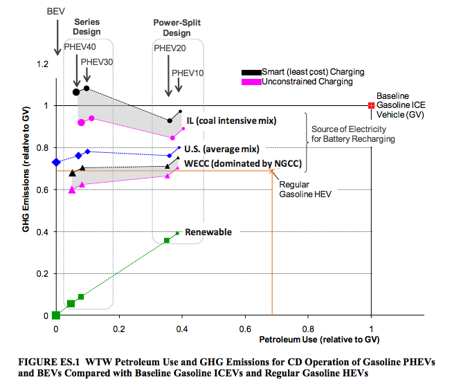

    AHA
    http://www.transportation.anl.gov/pdfs/TA/629.PDF
    Also by Elgowainy
    And my fav graphic from that article:
    As you can see, so called 'smart charging' INCREASES carbon intensity because it pushes consumers towards charging from coal, where it is more profitable for the utilities.

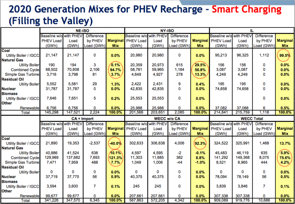

    Zythryn, the table below is also from Elgowainy, part of a SAE conference presentation in 2011. It summarizes findings from his published articles noted above but is easy to follow. This is 'smart' charging. It shows marginal emissions in action.
    It should be clear to the open-minded by now that grid charging of an EV has a carbon intensity in the range of NG to Coal, and that use of 'average grid carbon intensity' is simply wishful/poor thinking. And excuse me saying so, but I have been pointing this out for 5 years. I sure wish at least my Green friends at PriusChat would accept the obvious by now.

    You are picking and choosing.
    Look at the detailed graphs showing regional marginalized GHG emmissions. Most have lower emissions. The IL regional grid is such a large exception it takes the average in the other direction.
    Update---
    Your hypothesis seems to be that the marginal use will not improve as the grid as a whole does?
    As your table shows (also shown in my link), some grids actually cut coal use for increased power use. Yes, NG use increased, but the far more intense coal actually decreased in the CA grid.
    This is a good example of improvement being available in both the average grid composition as well as marginal requirements.
    Of course, all of this is based on the general grid and not calculating additional renewables and conservation that is a direct result of plugin ownership.

    The graph you picked out is good, look at the details.
    CA had a negative coal use and additional NG use, overall minimal. And again, they are calculating based on kWh, not efficiency.
    My understanding is that a coal plant running at low temps, as the demand for electricity is low, is less efficient, leading to higher carbon intensity.
    Creating more demand allows the utility to run at a higher efficiency, thus lowering the carbon intensity of the entire grid.

    Post #27: The table shows that of the grids analyzed, only 'CA+imports' has a reduction in coal use as EVs come online. Thank Enron ;)
    My point -- I doubt it qualifies as a hypothesis -- is two-fold:
    1. Overwhelmingly today, fossil fuels cover the margin.
    2. The oft declared rally that 'EVs get cleaner as the grid gets cleaner' is a canard.

    No argument with the first part.
    As I have already shown from the table you provided, there is a wide variety of grids, and improvement is possible.
    The huge step forward will be when grid level storage is solved economically.
