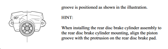

    If the inner brake pad (one in contact with caliper piston) has beveled wear, and half of the inside face of rotor is rusty (from lack of contact with pad), that's clue number two, that they screwed it up. Proper orientation is shown in attachment I posted previously.
    See if you can be present when they disassemble it.

    Ah no, would take some months. Look for the inner pad to have an imprint from the spoke pattern on it's shim plate, with the spoke over the pin (that's on the backing plate), as opposed to one on either side. And the pin would likely be showing some bevelling, be a bit chewed up.
    This is the pin that causes the problem:
    The piston, with it's 4-spoke pattern, presses against this, and the spokes should be on either side, straddling it. The pin is there to stop the piston rotating when you press the parking brake. It can be assembled mis-oriented from the get go, so a spoke is over the pin. Or if it's assembled proper orientation, but not well seated, it can ride up there when you apply the parking brake. And once it does, you're getting grossly uneven brake pressure, and constant drag.
    If everything's put together properly, you should be able to give the rear wheel a bit of a push and watch it rotate one or two rotations. If a good push yields 1/4 turn only, it's dragging.

    If the 3rd gen rear (disk) brakes are misassembled, with a push like that it'll stop more or less as soon as you let go. And it's noticeably stiff to turn.

    Yeah, the left rear looks to have too much drag, and the one thing I can think of is the caliper piston misalignment. It must be reassemble with piston oriented like an "X":
    And then, the brakes should be pumped multiple times, to get the piston well seated, then the battery reconnected (good to do at the outset), then a short, easy on the brakes test drive, and only then apply/release the parking brake several times, raise the rear, and verify they are spinning near-freely.
