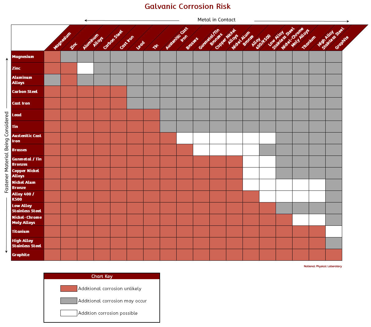

  8. ChapmanF
    21,571
    14,052
    If the studs are steel, or zinc-plated steel, I think titanium nuts will make a corrosion battery of nearly a volt. No, the titanium nuts won't corrode, but oh, those studs .... :eek:
    Elektroingenieur likes this.

  13. ChapmanF
    21,571
    14,052
    I'm not sure which way the regular heating of exhaust manifolds really plays. Yes, they dry themselves out regularly, but they also seem to be sites of some of the heaviest corrosion seen around a car.
    Copper to steel looks like only around a third of a volt on the galvanic chart I'm eyeballing, way lower than titanium to steel.
