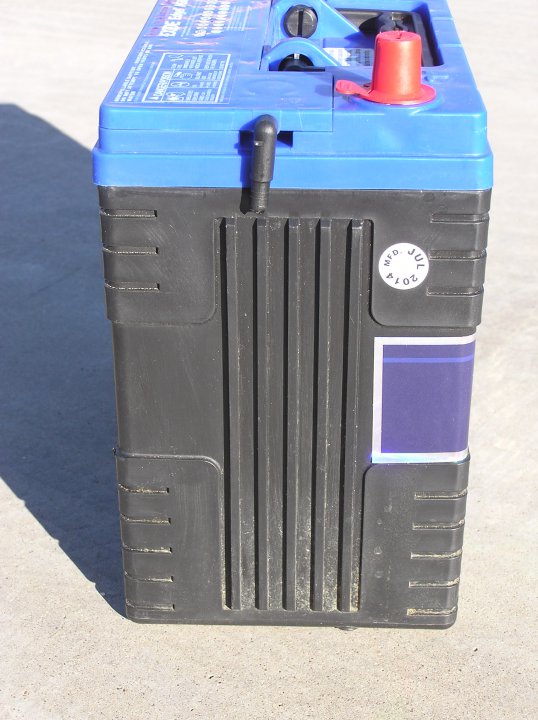

    I am thinking of buying a Canadian Tire MotorMaster Eliminator 12V battery which is a rebranded Exide battery. The AGM battery should be better quality than the OEM lead acid. I am trying to figure out how to install it.
    Another battery for the Prius. | Page 2 | PriusChat
    For those who have installed the Exide battery before, how did you install the vent tube? Did you simply remove the OEM elbow and attach the new elbow to the OEM rubber vent tube? Or did you have to replace both the OEM elbow and rubber tube?

    Yep. My main concern is the vent tube. I wanted to know if I had to buy my own, but I will trust David's post and try to use the OEM elbow. Below is the Exide battery. Previous posts have indicated that the vent elbow hole is smaller.

    If that is your battery in the picture just pull the elbow off the hose and shove the hose on the installed elbow. Save the original elbow "just in case". ;)

    manufactured in july 2014....??
