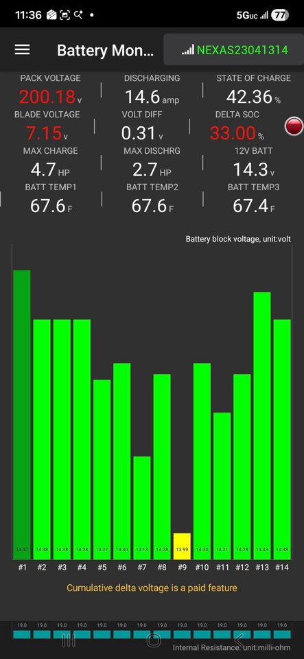

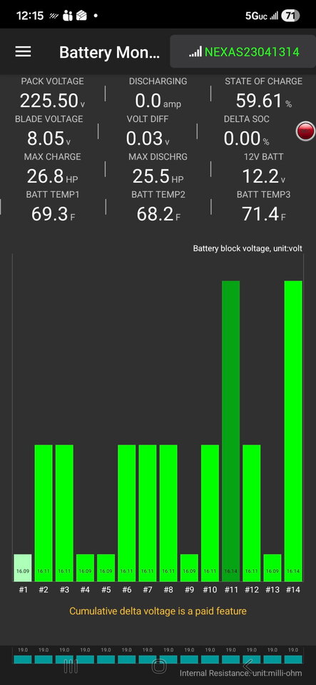

    Had P0A80 code and battery was replaced. Code came back shortly after the new battery was put in. I'm trying to figure out if the cause of the code was actually the battery or if something else triggered it. I have no idea how to interpret these readings. Can you guys tell me what these two pictures tell me about the batteries?

    The first photo everything looks fine, but the 2nd one looks like one sell is low.

    There is no unusual data show in the first Dr Prius screenshot. It appears that this was taken when the car was in ignition on mode (car not in Ready). The second screenshot looks like the car was in Ready mode and shows a Delta SOC of 33%, which is not good. This is telling you that the battery blocks are not balanced to each other. A healthy battery pack has a Delta SOC of 0%.

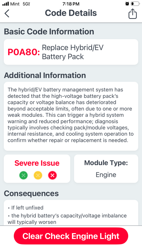

    Thanks, Brian1954. Yep. It's active. I have the triangle and "check hybrid system" message. I do have them coming back out next week. I just use a FIXD scanner. Here's a screenshot. Thanks for the scan interpretation. If the first shows the battery is fine, do you know why else the P0A80 code would still be active?

    fixd is likely incorrect.

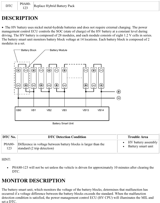

    There is a voltage difference between blocks of more than a third of a volt there between highest and lowest, likely the explanation of your P0A80 code.
    (Hey, I just noticed for the first time a typo in that page of the manual: it says there are eight cells in a module, but should say there are six.)
