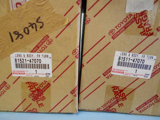

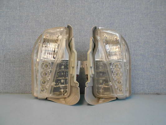

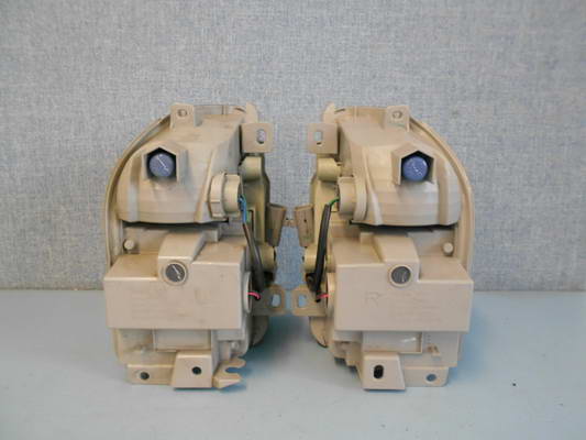

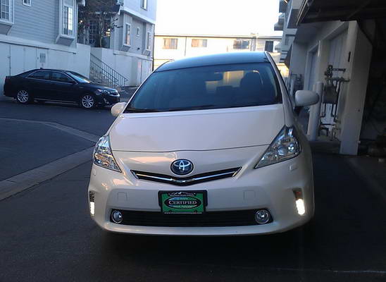

    On the EBay, I purchased from UK a set of original DRLs for 2012 Prius Plus parts # 81521-47070 and 81511-47070. It cost me including shipping to CA about $200 and installed myself in an hour without any difficulty. I hooked up through relay - as soon as I turn on the main lights, they turn off automatically, it’s very comfortable.
    PS UK EBay item # 181468922127
