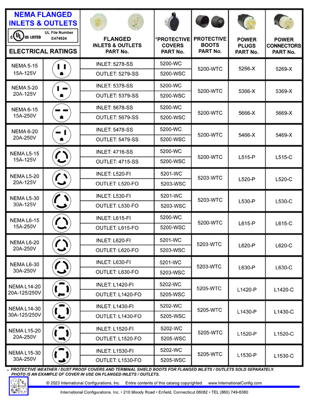

    Yes my outlet looks like the top picture. So I think if I get a 10/3 cable at 10ft or 25ft I should be safe right?

    As far as the wall socket you'll find, most likely the socket is the super standard 120V, 15A plug, connected to a circuit with a 20A breaker. These are standardized by the national electric code. If the left connector on the socket has a horizontal line in addition, then it's a 120V, 20A plug, most likely connected to a 25 or 30A breaker (though it's not rare for these too to only be wired to 20A breakers). These are completely safe to plug into with the normal 3 prong plug.
