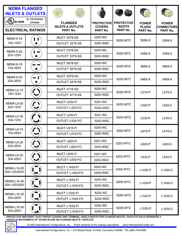

    Can you photograph the receptacle and post the picture here?
    15 amp 110 volt receptacle with polarity

    For our purposes, you can think of 15 Amps as the shape of the plug.
    It is very likely your out let resembles the top one, rated 15 amps.
    Thick wire just means less heat in the cord and more power makes it to the end of the cord.
