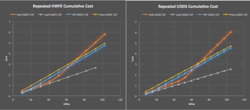

    IMHO the OPs result looks pretty reasonable. Without the tax credit, the Volt is expensive. PiPs have been about the same price as a regular liftback, but with no incentives right now and no tax credit, its not too surprising that it doesn't work out financially. Incentives may come back by next spring?
    We do seem to be approaching a point where plugins can make sense from a purely financial perspective in some cases, but for the most part there still has to be some non-financial motives to push the decision over the top.
    From a financial perspective it still seems like what makes the most sense is highly dependent on usage and local electric rates, but in general I'd say it seems to work out that the most cost efficient choices are:
    Lots of short trips (up to 16-18 miles) with opportunity to recharge between: PiP
    Lots of medium trips (17-60 miles): Leaf or Volt
    Regular longer trips (60-120? miles): PiP
    Regular long trips (120+ miles): Prius
    In the OPs case its seems like his long trips are dominating fuel costs.
    EDIT (updated ranges based on chart below)
    Rob
    #33 miscrms, Sep 26, 2014

    agree with rob, in most scenario's, regular prius saves more money, especially at current fuel cost. i bought mine for all the advantages of a prius, plus the pure fun of ev driving. just went 14.4 miles to home depot and back, all ev, pretty sweet!;)
  15. miscrms
    miscrms Plug Envious Member
    Aug 21, 2007
    2,079
    527
    Phoenix, AZ
    BTW, here is the data behind the claims above. This is calculated from the ANL D3 Database numbers. The costs themselves are optimistic, because they use the UDDS (city) and HWFE (highway) driving cycles, but it should be a fair comparison between vehicles.
    #35 miscrms, Sep 26, 2014

  18. miscrms
    Aug 21, 2007
    2,079
    527
    Phoenix, AZ
    Added Prius to graph.
    Agreed CB, if PiP and regular Prius are same price the PiP wins every time. If PiP is more expensive, its hard to make up the difference if your driving is dominated by long trips.
    FWIW I think the PiP/Volt/Leaf/etc are still very much worth it, but that's because I value other non-financial benefits into the equation. This is data is intended to just address the pure financial side of the discussion.
