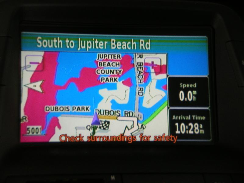

    <div class='quotetop'>QUOTE(PriusInsight @ Oct 10 2006, 07:24 PM) [snapback]330872[/snapback]</div>
    At the moment its just laying under the passenger's seat. Things are too hectic right now for me to do a proper installation. We leave for NY in ~36 hours.
    If you haven't read my earlier threads, you need to first do the "anytime backup camera" mod, which will allow you to force the MFD to look at the auxilary video input whenever you want. Darrell did a writeup of it here too:
    Anytime Backup Camera Mod
    Then, if you scroll to the very bottom of Darrell's page, you will see where he copy-and-pasted from an email where I told him how to splice into the camera cable to add a DVD/external video jack. That jack is where I'm plugging in the GPS video now. Someone REALLY needs to do this and do a proper FAQ with pictures. Anyone??? B)
    The audio was a little trickier, because you certainly don't want to drive around with ONLY the NAV lady to listen to. I have a Sirius radio plugged into the Auxilary jack in the console, which is what I listen to 99% of the time. So, I decided to just have the GPS interupt the Sirius audio whenever the NAV lady speaks. The Garmin GVN 52 provides a "Mute" wire, which pulls to ground whenever the NAV lady speaks, but it can't sink much current at all. So, I had to use a transistor to drive a DPDT relay, which does the switching back and forth between Sirius and the NAV lady. Not the most elegant solution, but it works fine. I would think that there are probably off-the-shelf audio switches that you could use, but I wouldn't know where to get one.
