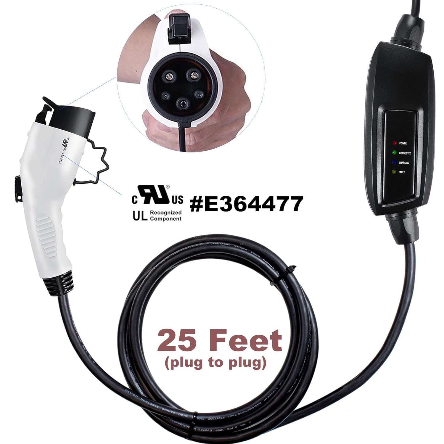

  5. hill
    21,530
    9,041
    20amp breaker - so it'd max @ 3.6kW's. Bare minimum nowadays & leaving no room for future proofing. Still - beats the heck out of OEM L1's provoding one measly KW per hr (after AC - DC conversion).
    whacky-est uber cheep price for a 9.6kW unit?
    from Texas;
    MUSTART Level 2 Portable EV Charger (240 Volt, 25ft Cable, 40 Amp), Electric Vehicle Charger Plug-in EV Charging Station with NEMA 14-50P [PB5W808G] - $69.99 : prcedo.com
    i duno how the do it!!
    all you'd need is a 50/30 adapter . . . . . . .
    and . . . . . . . . a 50/20 adapter;
    there's even 50amp 240 to 120 adapters too.

  7. Rob43
    Rob43 Senior Member
    Sep 24, 2014
    1,373
    1,050
    VA, BMW Race Car, BMW R1200R, BMW 330Ci, Ford F350
    2013 Prius v wagon
    I just Tested this unit, this EVSE failed with 1 minute & 20 seconds of operation.
    But what I found worse than that was how incredibly TIGHT the white charge handle was while trying to plug it into the Prime, the Prime or the white handle would have broken within a short period of time IMO.
    Rob43
    Worldbuyer likes this.

  9. Rob43
    Rob43 Senior Member
    Sep 24, 2014
    1,373
    1,050
    2013 Prius v wagon
    I tested the "white" handled EVSE unit that forum member "hill" pictured, that's why I quoted that post.
    That white handle was very very tight, even if the unit had not failed, I would have still returned it based on that.
    Rob43

  11. John321
    John321 Senior Member
    Nov 16, 2018
    1,545
    1,448
    Kentucky
    One thing that may be of interest and even a requirement for some consumers is that neither devices is apparently UL listed.
    Worldbuyer and jb in NE like this.

    The Amazon unit is a UL Recognized Component in the US and Canada. This article explains that power supplies and power converters are never 'Listed' they are always "Recognized"
    What is the Difference Between UL Listed and UL Recognized? | CUI Inc
    #15 JimboPalmer, Jun 2, 2019

    So, the power supply meets a standard but the connected wiring and plugs do not have to? That kind of defeats the purpose of ensuring the whole assembly meets established standards.

    The UL seems to feel that power supplies and converters are never products that a consumer would buy, they are components in a larger product. It would be pointless to have an EVSE if you did not have an EV that needed it. I believe the entire EVSE is a single component in this scheme. (I do not make these rules)
    [OK, I googled more and the certification number E364477 is on a lot of EVSEs with the brick made by the same company, so it is only the brick that is UL recognized with that number.]
    The Handle is also UL Recognized, while the cable has TUV marks.
