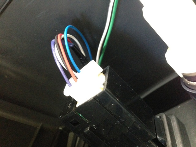

  4. Ajwatuc
    Ajwatuc Junior Member
    May 14, 2013
    75
    This is a picture of underneath. It is a plug youd have to figure out which wires go to what and hard wire a 3.5 mm plug in ImageUploadedByTapatalk1371816544.235830.jpg

  6. prius2010II
    prius2010II Member
    Aug 19, 2010
    278
    27
    us
    Some of the Chinese Toyota/Prius specific HU have the console plug live as part of the regular install.
    The Metra harness for their steering wheel control unit have jacks which plug into your RCA aux plugs. It accepts input from the console aux jack without any additional cutting or splicing.
    70-8114 is the Metra part number for the harness. You also need the steering wheel control unit.
