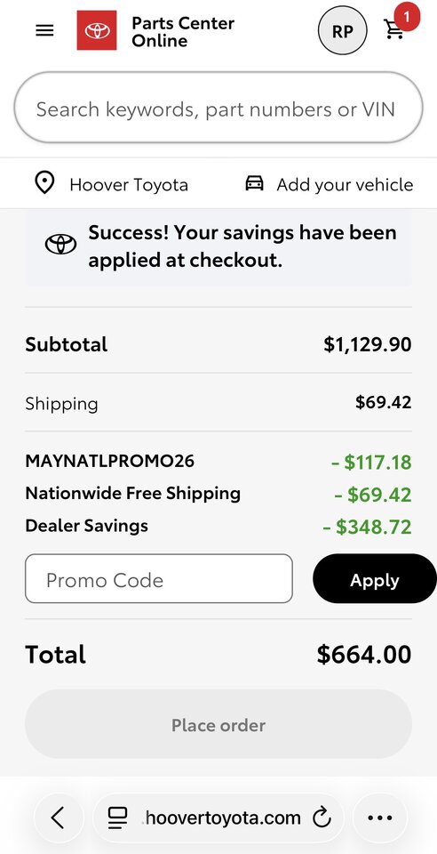

    Many times mentioned but you have to shop more than a few dealers - their pricing is not the same. You also have to put it in the cart to see holiday savings (a low 15% below normal online dealer prices this time probably caused by gas prices) but this dealer gives free shipping as well.

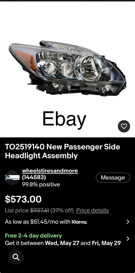

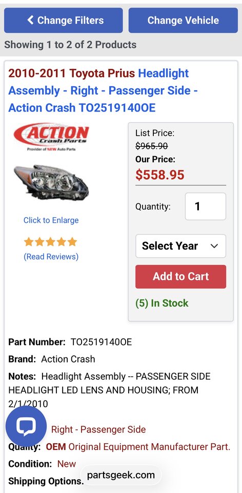

    I would either buy a new led housing (built in low led with high halogen) or shop ebay and LKQ for used or consider a new aftermarket (TO2519140OE) assembly.
    #7 rjparker, May 23, 2026
