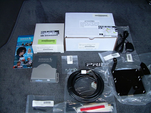

    Hi there. New 07 white #4 owner (I was trying to get a #5, but there are literally none available within 500 miles), formerly an 02 Classic owner. I ordered the fit kit and receiver (PTS31-47060 and PTS31-53060) through AuthenticToyota.com (I would have got it from priuschat.com, but I don't trust PayPal for large transactions and didn't want to wait for check), and it arrived in about 2 days. I took out the camera and here's what I received:
    More pics are here. It even came with a copy of the TIS installation instructions. Instructions seem easy enough with enough work, but I'm going to have the local dealership install it so I have someone to blame if my 5-day-old car is damaged. :)
    Anyway, I don't see anyone else talking about this: everyone seems to know that you get 3 free months of XM and free activation when you get the XM Prius receiver, but I plugged the unit ID into my existing Sirius account tonight and all the packages that came up said "3 months free, OEM deal". I didn't go through with activating it yet (I'll do that once it's installed), but I just wanted to let you all know the Sirius units appear to have 3 free months as well. I think the Sirius activation fee still applies though.

    fo0bar - thanks for posting this picture! I just had a factory kit installed, but it went right from the parts deparment to service so I never saw it.
    Can I ask you the small black part in the lower left of the photo - is that a three inch long guide for the antenna cable on the roof? My dealer installed the antenna right against the edge of the roof and I think as a result I've got snigal problems.

    The black piece is an edge guard for where the antenna goes into the rear hatch. It goes over the sheet metal under the gasket, to protect the antenna wire. It's not a "tail" as used on other Sirius antennas.
