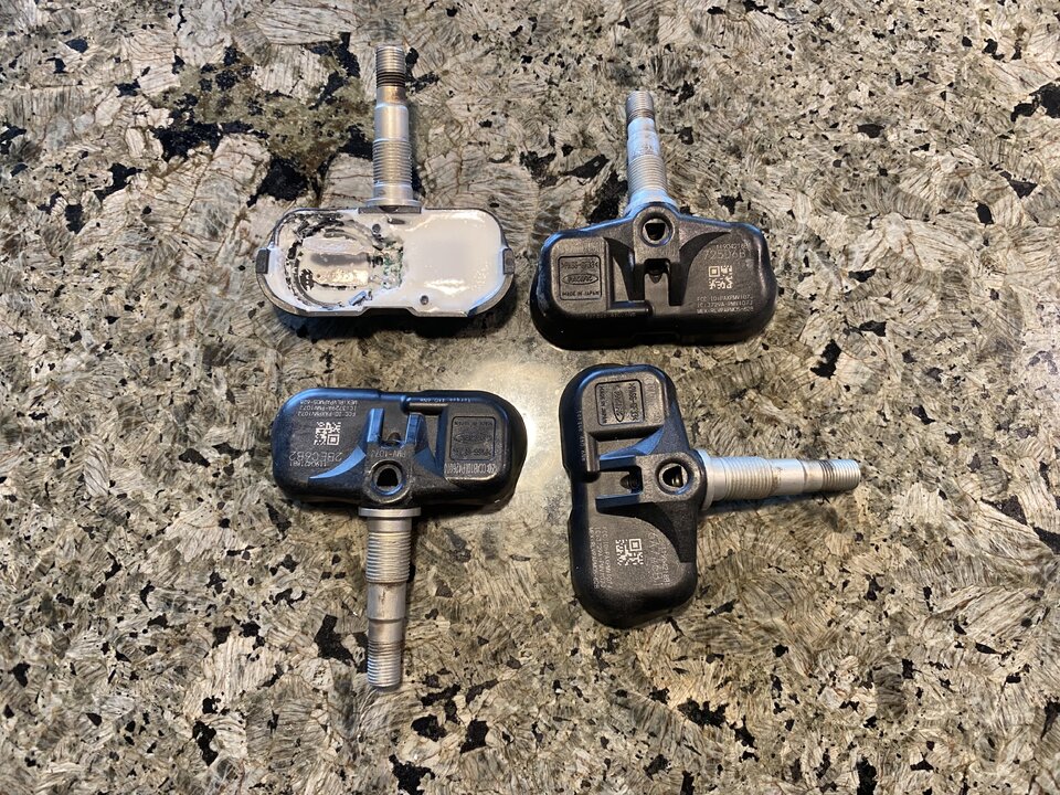

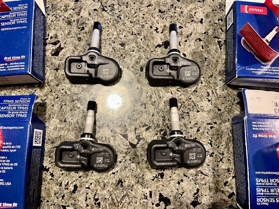

    I don't think CMIT # is the indicator for genuine. In fact, it is likely the counterfeit from my sample data. The original TPMS sensor came out of my 2011 Prius has no CMIT #. No Toyota Markings. They are made by Pacific Industries. Denso 550-0103 is exact match (~$40 sold by amazon/rockauto). Also no CMIT # and made by Pacific Industries. Denso is just the distributor. Bought 4 from amazon for $40+ each and been on the car for 2.5 years without problems. Also checked the ID codes are properly registered in Techstream.
    Original electronics is entombed in white silicone while new Denso is clear silicone.
    Here is pic of original and the Denso/Pacific Industry replacement

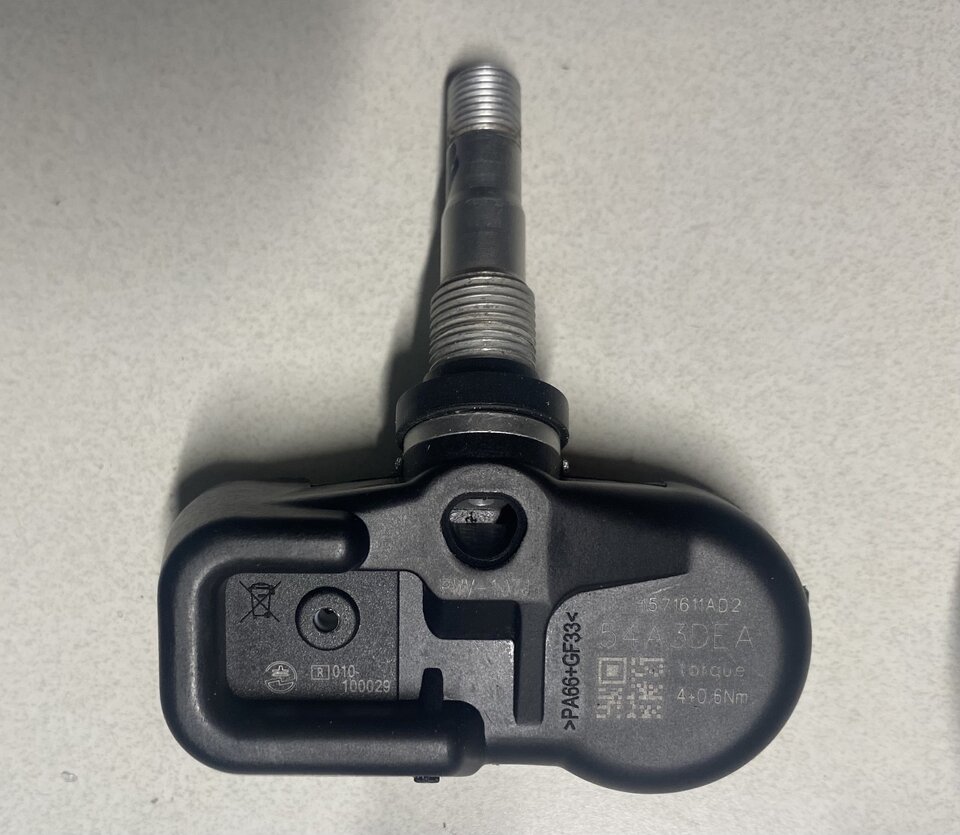

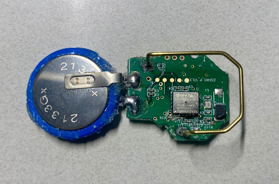

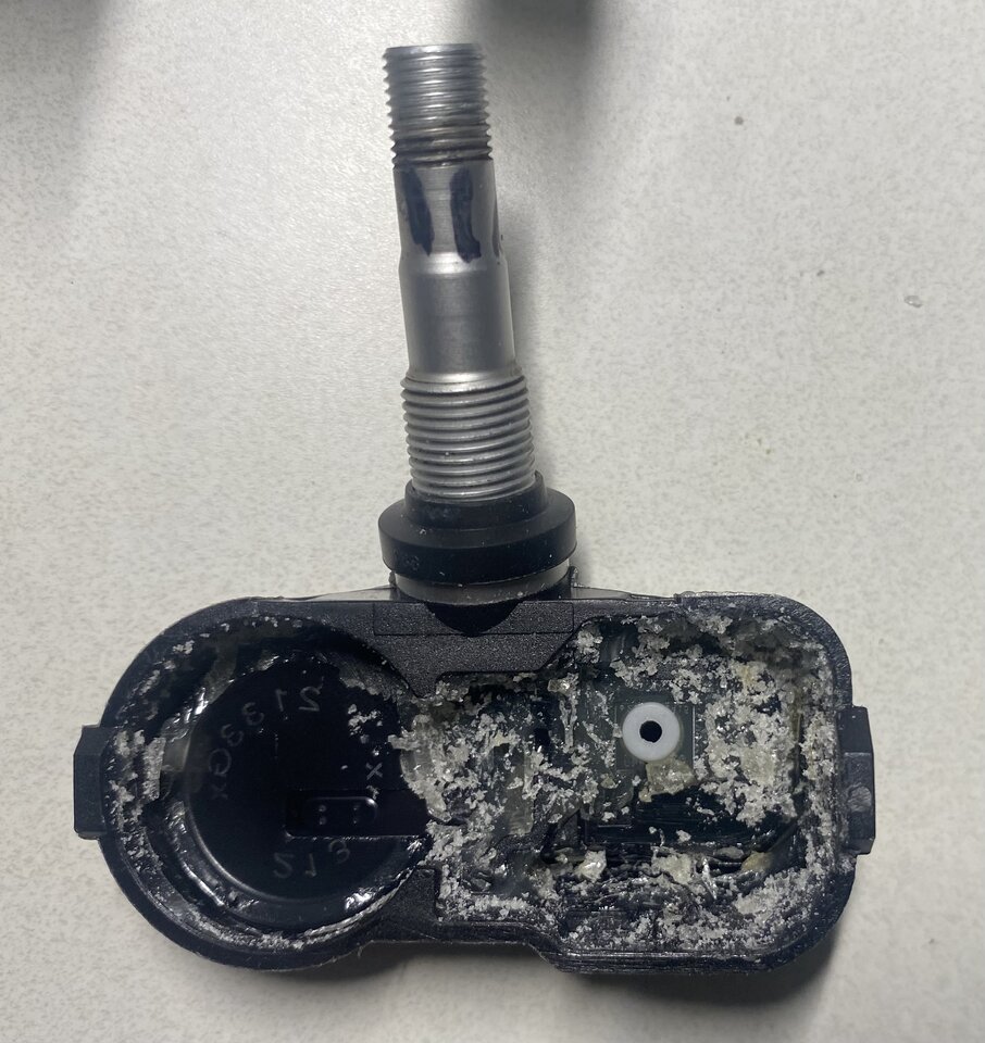

    Opened up a common no name brand TPMS from China. This one didn't copy Pacific Industries perfectly but in the general shape. Internal components are quite revealing. Its likely the internal component source is how majority of the cheap no name brand TPMS are made. I have a bit of chip design and chip fabrication background so who did the design and fabrication tells quite a bit.
    External TPMS looks quite similar to this one on Amazon and has the same company logo
    The Chip
    The chip is a AutoChips AC5111DBN. I know AutoChips well, they are one of the Chinese main chip design company for the cheap Android head unit available today. I have one in my Prius haha. For the headunit, these are Android Applications Processors. Think of it like the main chip in an Android phone but much less requirement for tiny size and low power operation. AutoChips by their name indicates targeting chips for cars. Here is a bit of history on them
    AutoChips Inc.(company)_Baiduwiki
    Founded in 2013, designed China's first integrated TPMS chip AC5111 in 2019. So I'd imagine all the $10/TPMS sensors appeared right after this time frame as cheap chip source became available. Here is the chip and its internal gory detail if anyone is interested.
    AC5111DBN/F2C | AutoChips | Pressure Sensors | JLCPCB
    TPMS chip require a fairly unique chip fabrication capability. There is analog sections and digital sections on the chip. This is called mixed signal chip and requires specialized expertise. Furthermore, it includes MEMS chip sections for the accelerometer and pressure sensor. MEMS stands for Micro-Electro-Mechanical Systems. Imagine a little tiny microscopic beam (like a wood beam in your house) that has tiny mass. When the chip is accelerated, the beam flex and amount of deflection is measured as acceleration rate. Was first mass produced way back in the late 80s by US company and quickly became key component for firing airbags. Anyway mix analog, digital, and MEMS all on one chip requires 10-20 years of expertise beyond just making regular chips. I was wondering if China's domestic chip fabrication have reached this level. The answer is no. Autochip's TPMS chip is fabricated at X-FAB, a German company/factory with roots in East Germany chip factory before the Berlin wall.
    AutoChips and X-FAB Launch Mass Production of China’s First TPMS Chipset: X-FAB
    X-Fab - Wikipedia
    Anyway, they are the source of expertise and factory for mix signal + MEMS on one chip.

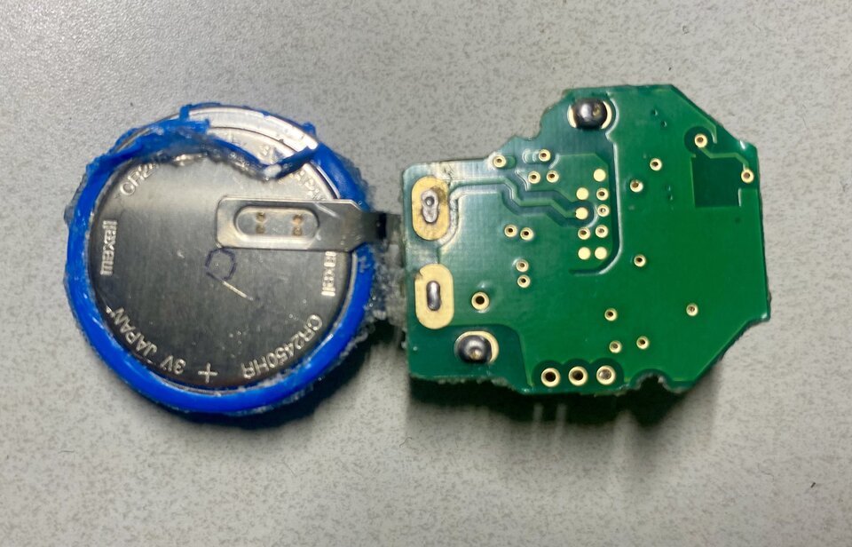

    The Battery
    Labeled maxell CR2450HR. I could only find this image in a KIA TPMS tear down that might be a reliably authentic source. All other images I found were little sellers on ebay/walmart/aliexpress etc.
    TPMS battery replacement - Maxell CR2450HR EX battery - Page 1
    The character labels markings seems to be more finely etched on than what I found in TPMS tear down above. I wouldn't imagine this is genuine Maxell but just a guess of course.
    Here is Maxell's main Asia subsidiary's website in Hong Kong and the consumer battery section
    Energy Products &#8211; Maxell
    Again, the etching print seems finer then the one I extracted. Don't know if thats just the consequence of aiming at end consumers instead of bulk supply to factories. Generally speaking, all the factory bulk supplied components I've seen are basically identical visual quality to their lower volume sold to consumer cousins.
