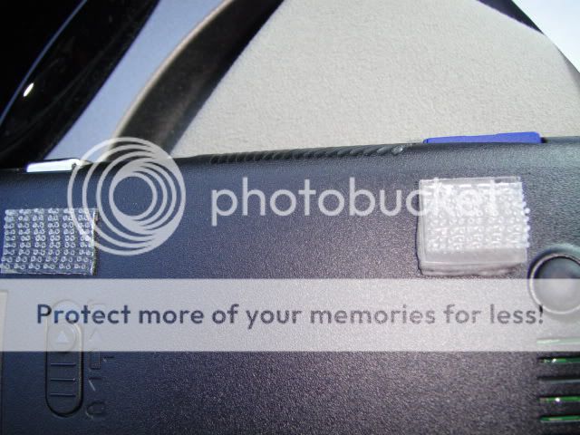

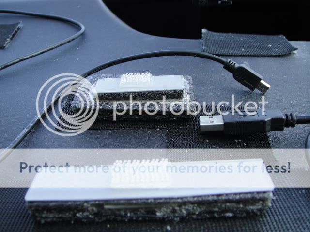

    Holding the laptop with a suction cup on the windshield does look scary. Here are some pictures of my current setup:
    Netbook attached:
    Netbook removed:
    Back of net book:
    What the dash looks like after many iterations of mounting configurations: :p
