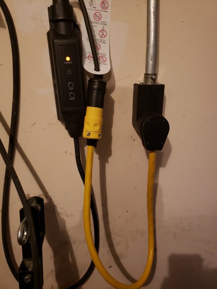

    For those of you that have a conveniently located 240 volt outlet near where you charge your PiP, you can Fast Charge your car in less than half time compared to right now.
    Your Toyota OE 120v EVSE unit operates perfectly at 240 volts, all you need to do is feed it 240 volts for fast L2 charging speeds. Imagine coming home from work with a 0% battery, then you go inside your home for a bit to relax & freshen up before you head back out for dinner somewhere; when you head back out your PiP is either almost charged or fully charged up !
    All of this can be achieved for less than $50 dollars if you already have a 240v outlet somewhere near your PiP.

    Home Depot certainly sells all the individual parts, but they don't sell a pre-made unit. You'd need to be very confident in your wiring ability or you might end up with expensive $$$ problems.

    Just take a few minutes & do some research in the Prime charging sub forum. I've built more 240v adapters at this point than I have hairs left on my head (lol).
    Using the Primes 120v Charger at 240 Volts, Cost $20 !!! | Page 9 | PriusChat

    Can you provide a link to this adapter, pre-made, at Home Depot? Or Lowe's? Or any other big box store?
    (Amazon and Alibaba vendors and international plug adapters excluded.)
    Openly advertising and selling such an adapter to the broader uninformed public is a recipe for burning or blowing things up. That is why you generally need to assemble your own, or go to a niche provider selling them only for a single specific purpose, such as here.

    Changing the plug locks you in to 220V only. No more charging from 110V while traveling away from home, unless you acquire a second one for travel. Or build an adapter anyway, of the opposite flavor.
    Yes, you can build your own adapter with parts from just about any vendor selling electrical supplies. Rob is assisting those who lack the skills or confidence to do it themselves.

    This Won't Work....
    What you don't know is there's a Temperature Sensor inside the NEMA 5-15P plug on your Toyota EVSE, Toyota put this sensor there as a safety device.
    Your Toyota EVSE is always monitoring this temp sensor, if you remove the plug the EVSE goes into fault mode.... Your EVSE becomes an expensive Paperweight.
