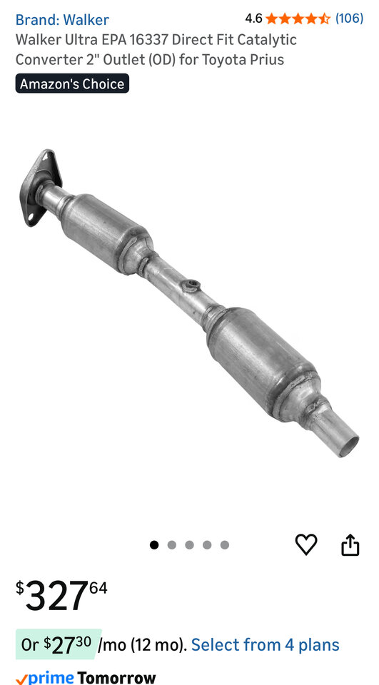

    Would it help to buy an OEM used catalyst from a salvage car on marketplace for a few hundred and pass your State inspection? Many have been replaced with OEM by insurance in the past 4-5 years when it was the peak of theft and have low mileage since then.
    danboy likes this.

    There is a kit to add an ev button to a gen2. Not that important unless you need to sneak out in the middle of the night.
    There are gen2 aftermarket cats that do clear codes and keep them off.
    Walker 16337
    I have seen them last years with no codes.
    Napa 16337 is the same cat
    Napa 16337 Catalytic Converter? Check Engine Free? | PriusChat
    danboy likes this.

    That is an EPA approved catalytic converter. NY is a CARB state. CARB approved catalytic converters are substantially more expensive. The one on this link:
    2007 Toyota Prius Catalytic Converter
    is almost $2686. That said, going to
    Aftermarket Catalytic Converter Database
    and looking up for a 2007 Prius shows some that have a sort of exemption, not sure how that works out in practice, it is legalese.
    Executive Order
    That link may be using cookies, the document in question for Walker cats starts with:
    EXECUTIVE ORDER D-182-81
    Relating to Exemptions under Sections 27156 and 38391
    of the California Vehicle Code
    Walker Manufacturing Company
    “Series 85000 and 85100 Three-Way Catalytic Converters”
    and finally gets to
    THEREFORE, IT IS HEREBY RESOLVED that Walker’s series 85000 and 85100 TWCs are
    exempted from the prohibitions in VC Sections 27156 and 38391 for installation on the
    approved vehicle applications specified in Appendix D-182-81 subject to the following
    conditions:
    (a whole page of conditions)
    Walker has a tool to look up approved cats
    Exhaust Parts Lookup | Walker Exhaust Systems
    and they do not list one for a 2007 Prius for California or New York. So what use is the exemption good for? Looking at "all other states" there are three entries, including the one in the preceding post, and they say not legal in CARB states.
